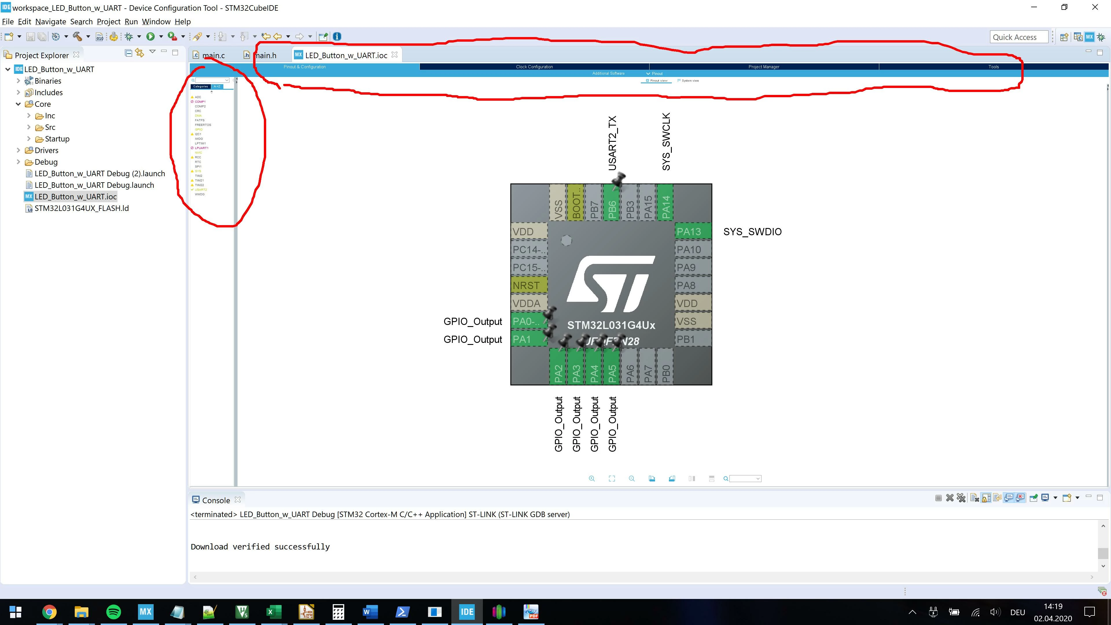

4K resolution screens: CubeIDE Device configuration tool too small to read
Almost 4 years ago Imen DAHMEN (ST Employee) promised us to address the 4K displaying problem using CubeMX. It was (IMHO) never solved, I was working with the Windows compatibility mode instead, which solved some part of the problem, but some fields couldn't be read/written in the configuration settings anyway.
Now the CubeIDE came out, where it's not possible anymore to start the configuration tool using Win10 in compatibility mode anymore - and the PROBLEM IS STILL NOT SOLVED!
Please ST, do something. It's just not possible to work with the CubeIDE, when you want to make the configurations using the configuration tools with high resolution screens!
Thanks for addressing this ASAP and taking this serious this time...
Best regards, Simon

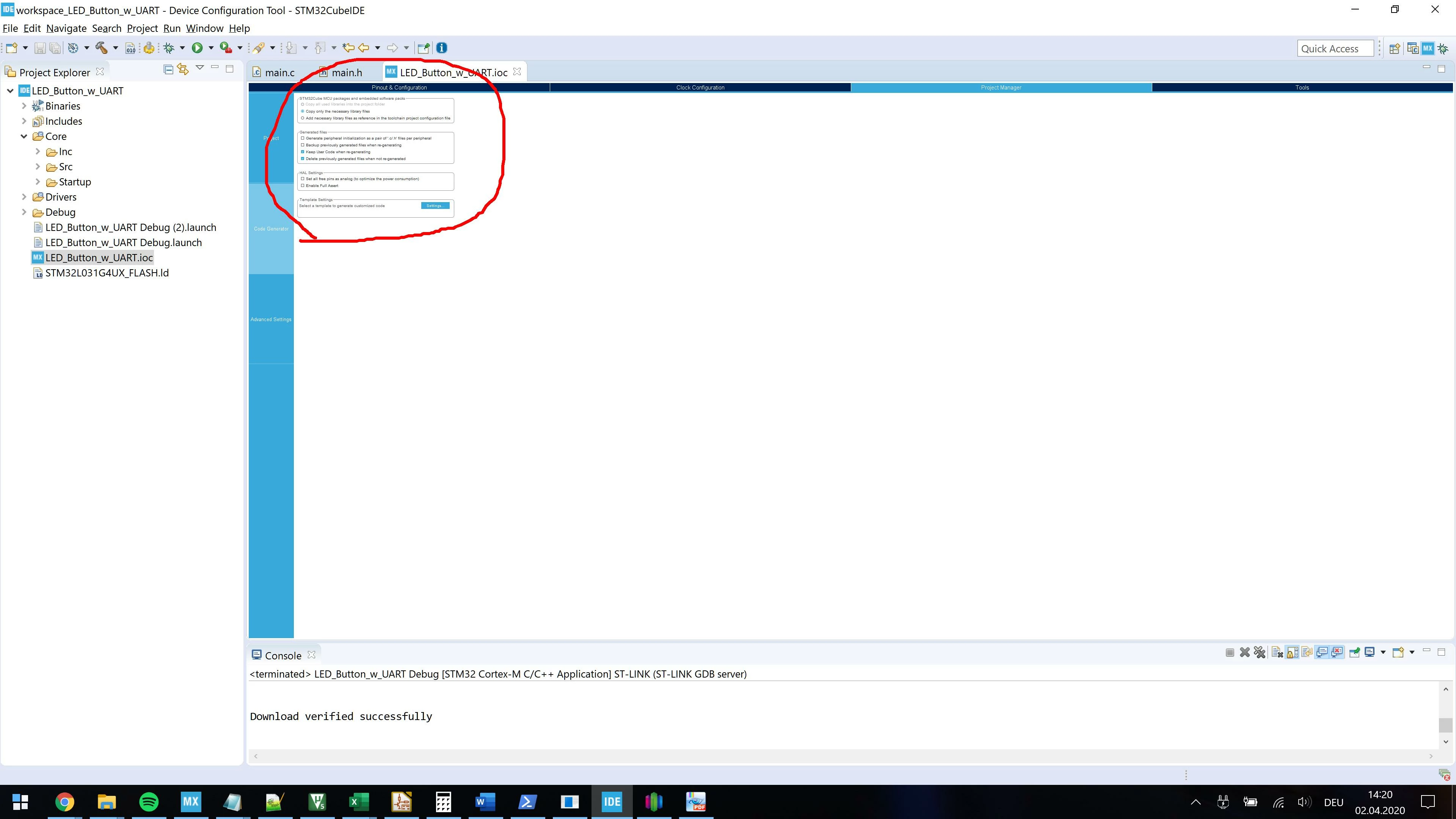

0693W000000VJX6QAO.jpgHi Aymen,
Thanks for this tipp!! Found it under
Window > PREFERENCES > STM32Cube > Device Configuration Tool > Font size.
This indeed helps for most of the text, but especially the text in the registertabs and the icons are not are not (yet) influenced by that (see attached screenshot). But it's definitely possible to work like this, thanks!
One recommendation: Wouldn't it be an easy thing to switch this automatically after installing the CubeIDE, so all people with 4K screens don't have to struggle over this? Pretty sure many out there still had the same problem and couldn't find this settings...
Thanks again, this solved the problem for me.
