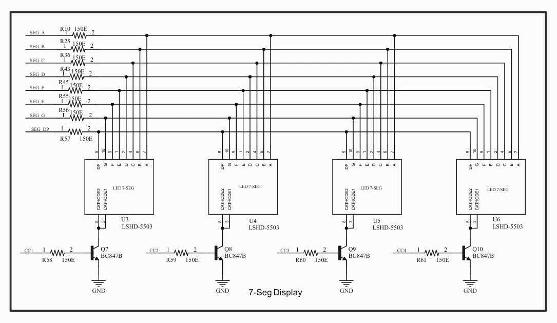

So, I'm trying to display a 4 Digit number on 4 7-segment Display using multiplexing
The issues are - 1. I'm using different Ports for Segments and Different Ports For common Cathode Pins ( I'll add the code below)
                          2. I'm Directly using GPIO to segment Pins without having any IC in between
Flow of the code is as follows :-

Here my increment and decrement function is working as expected but I'm not getting how can I display that counter values on 4 7-segment
I wrote a code as follows
In this code when i press up button only 3rd display is constantly turning on with value all other display just turned on for fraction of sec and then turned off. I want it continuously to display the values which are incrementing and decrementing
(sorry if the code is confusing i didn't comment or remove some unnecessary part)

There are numerous big and small problems with your code:
1. Display refresh must be done in a timer interrupt; otherwise you cannot display anything continuously (actually, with a proper connection, display refresh on STM32 can be done in hardware using DMA, without interrupts).
2. Your refresh routine results in ghosting - a faint shade of a neighboring digit visible on the display. The sequence in a refresh routine should be: turn of all digits, set the segments for the next digit, activate the next digit.
3. const declaration inside of a function without static attribute results in dynamic creation of digit decoder array on every function call.
4. You could avoid switch statements by keeping the port and bit data in an array of structures.
As always, the way to approach this is to get one part working at a time - don't try to do everything all at once!
So start with some code which just displays a 4-digit number - get rid of all the other complications of buttons, counters, etc.
It needs to;
  1. Select the first digit (ie, activate its common cathode)
  2. Write the segments for the first digit
  3. Pause while the digit is displayed
  4. Deselect the first digit (ie, deactivate its common cathode)
  5. Repeat for the other digits
Use the debugger to step your code and see that it's working.
You could also use the debugger to change the number being displayed ...
This is not the right way to drive the 7-segment display. You need to take care about the currents source/sink as you can break the IOs of your MCU. So you need at least a current booster on GPIOs using transistors or similar on common Cathode pins to drive the display.
You can find many schematics on the net on how to do this.
Omkar23Author
Thanks for your reply
I have 4 PNP-Transistor which i connect to the 7 segment in order to drive it. I created one schematic which I connected here.
You can check
