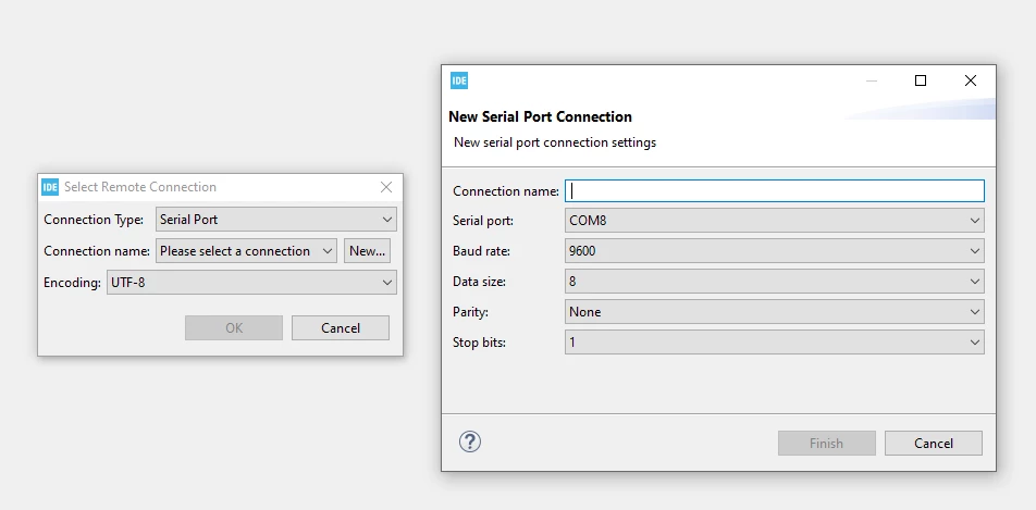

1. How can we watch the PWM signal output in the Stm32 cube ide ? 2. How can we watch UART serial-based output console in the STM32 cube ide?
I need answers with producer for above queries for learning about stm32 mcus with stm32 cube ide.

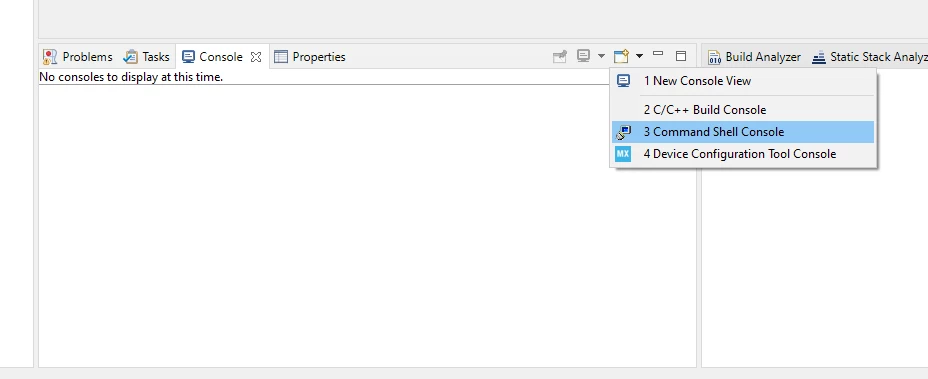

  • UART console
Create a new Command Shell Console.
0693W00000aJOQoQAO.pngConfigure the new Console  just as you did with PuTTY.
  • Also, You can too open a console emulator such as TeraTerm. Configure the console baud rate and data bits length. The COM Port name may differ on your PC.

kotesh
koteshAuthor
Mar 21, 2023 9:07 AM UTC
Regarding PWM watching console, does not have any inbuilt console in stm32 cube ide?
Foued_KH
Mar 21, 2023 9:17 AM UTC
For the UART communication, check this link :Getting started with UART - stm32mcu (stmicroelectronics.cn)
PWM: try to debug ,check the value of the registers and get the results via an Oscilloscope.
