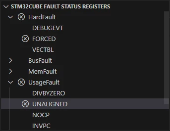

Graduate II
Hi PierreB,

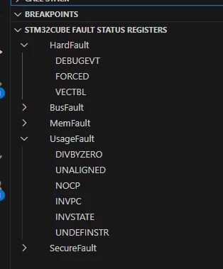

There is a view that shows the type of error occurring:
And I know that the "unaligned access" error is enabled by default in the ST debug configuration.
You can check the attributes starting with "fault", ex: faultUnalignedAccess
PierreBAuthor
Yes, it's an Unaligned fault, and there is no error when I add the argument "-mno-unaligned-access", but I'm not sure exactly what that implies, and I'd rather not modify the default cmake configuration, since it works with the cortex-debug plugin and with CLion (with the same elf file).

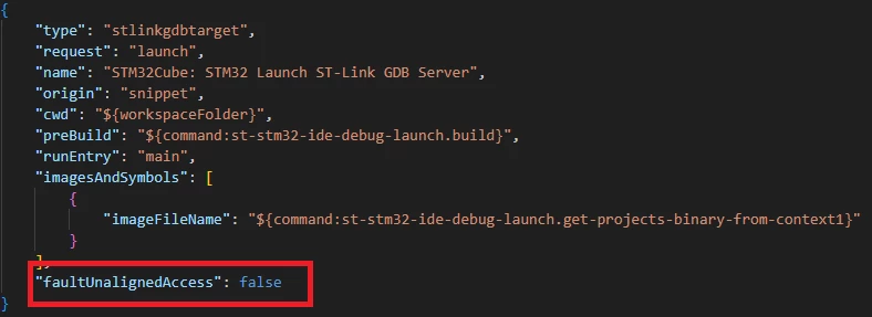

Graduate II
On my side, I simply disable it by setting the attribute to false in my debug configuration.
PierreBAuthor
It's perfect, I checked on CLion and cortex-debug, the “faultDivByZero” is also disabled on this registry.
Anyway, it's all clear to me now.
