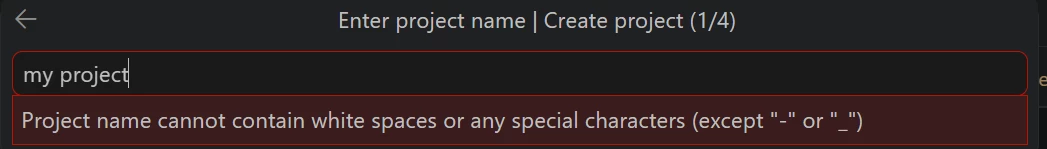

In CMake, special characters are not supported.
If CMake directives are adjusted, this support can be enabled. This behavior was supported in the past, but the decision was revised. The added CMake syntax is too complex for the limited benefit.
For now, the extension that creates an empty project must reject special characters, including spaces.

The failing project’s name is “asdf”. The project was created in “STM first try”/.
Hence, the create project menu did not detect or avoid this issue.
If you chose not to support spaces I recommend updating the process to inspect the full project path.

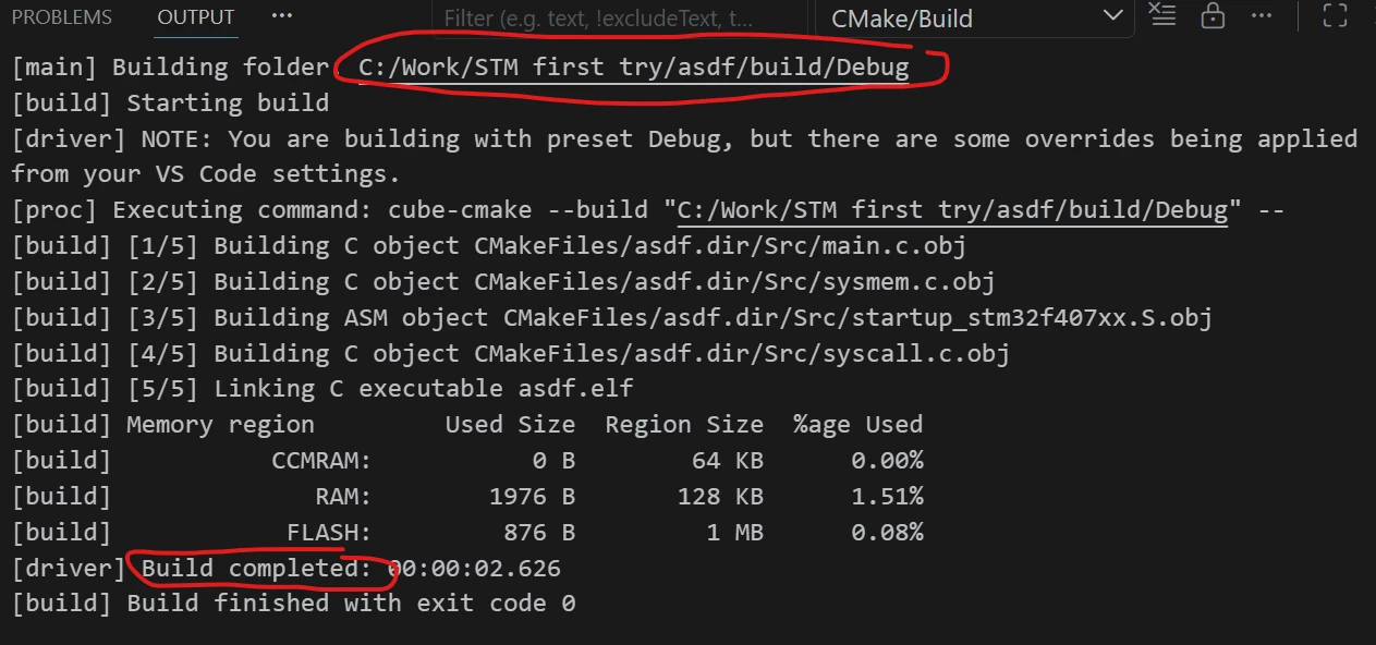

Jul 15, 2026 7:24 PM UTC
​@worker
My bad. My comment referred to the project name, which includes a space character. The shared information shows the parent path of the project.
GCC supports this. STM32CubeIDE for Visual Studio Code supports this too.

Could you share the terminal call to arm-none-eabi-gcc.exe?
Further testing shows the problem is unrelated to the “create empty project” feature.
The double quote issue appears when importing a STM32Cube project to a folder with a space.
The same project can be imported to a folder without spaces and compiles successfully.
