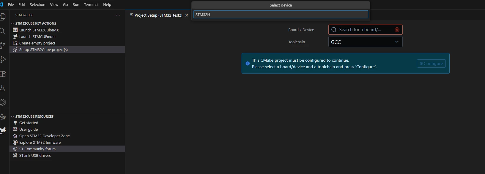

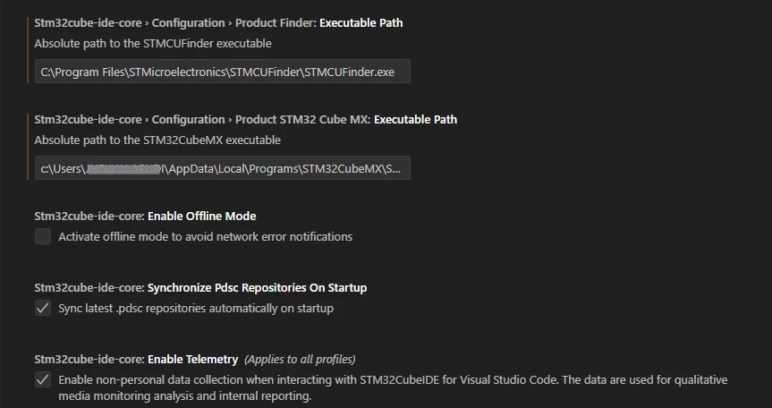

Hi I am trying to configure a project in Vs code.
1) Created/Generated a project using STM32CubeMX.
2) in vs code extensions added
3) by using open folder latest created project loaded
4) on pop-up Debug option selected
5) Then when it comes to device selection unable to find STM32H7 Series, eval board numbers in the list.
Note : STMCUFinder path, cubemx paths configured . please check below images

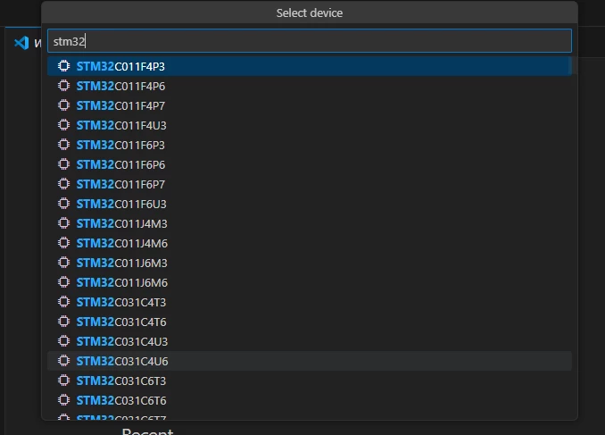

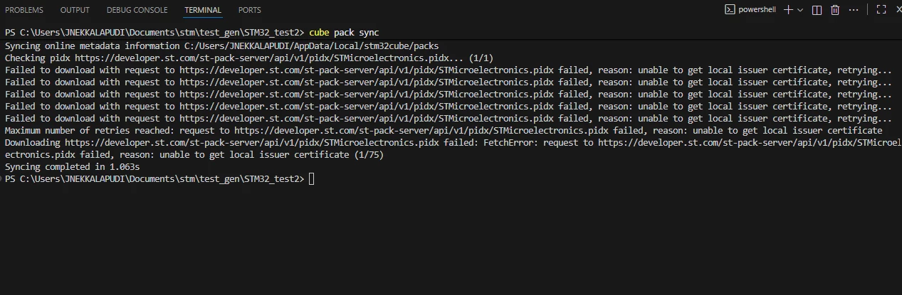

@Jagan1
Please let's skip this quick pick and focus on the red text field. Has any device completion appeared when you start typing STM32...?
If not, could you please try running the following command in the VSCode integrated terminal:
cube pack sync
Does the process complete successfully? If not, please share the trace.
Jagan1Author
October 24, 2025
Hi @vincent_grenet , Other boards/devices showing only STM32H series missing.
unable to sync also .

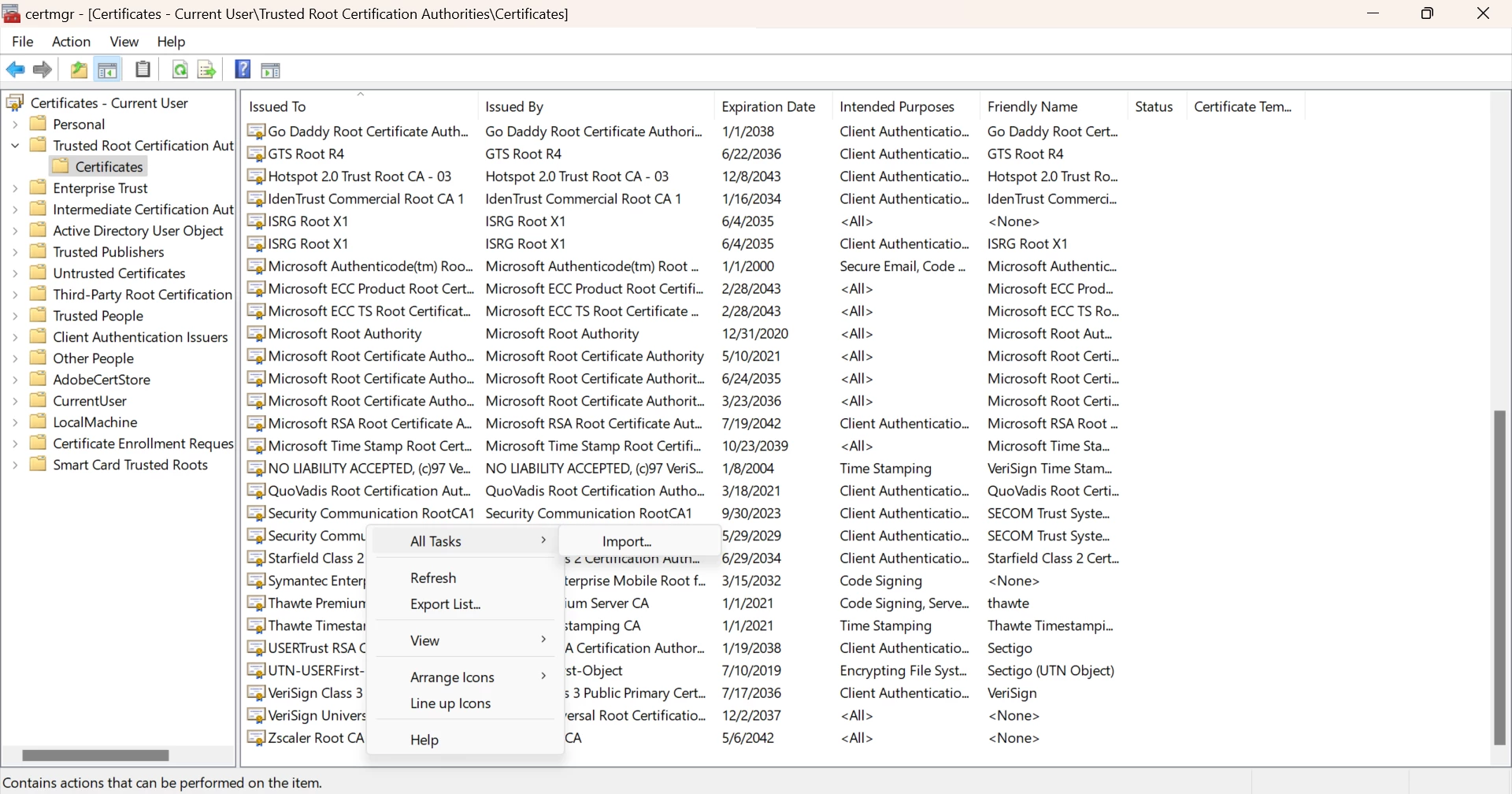

If you can navigate to https://developer.st.com/ without troubles it likely means that such certificates are already trusted into your Windows certificate manager.
JulienD_1-1761314026173.png capture picked from the internet
You could try export them (Zscaler*) in base-64 encoded X.509 format, and gather all exported files into a .crt file respecting this kind of format:

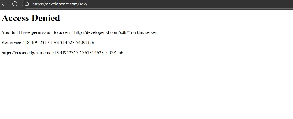

Julien D
October 24, 2025
Ok, it is denied but at least you have the lock meaning connection is secured, so you can proceed with the rest of my previous message.

Hi, fallowed same steps, only one Zscaler is there in certmgr and exported, still same issue.

PS C:\Users\JNEKKALAPUDI\Documents\stm\test_gen\test5> cube pack sync
Syncing metadata information C:/Users/JNEKKALAPUDI/AppData/Local/stm32cube/packs
Snapshot is already up to date
Syncing online metadata information C:/Users/JNEKKALAPUDI/AppData/Local/stm32cube/packs
Checking pidx https://developer.st.com/st-pack-server/api/v1/pidx/STMicroelectronics.pidx... (1/1)
Failed to download with request to https://developer.st.com/st-pack-server/api/v1/pidx/STMicroelectronics.pidx failed, reason: unable to get local issuer certificate, retrying...
Maximum number of retries reached: request to https://developer.st.com/st-pack-server/api/v1/pidx/STMicroelectronics.pidx failed, reason: unable to get local issuer certificate
Downloading https://developer.st.com/st-pack-server/api/v1/pidx/STMicroelectronics.pidx failed: FetchError: request to https://developer.st.com/st-pack-server/api/v1/pidx/STMicroelectronics.pidx failed, reason: unable to get local issuer certificate (1/75)
Syncing completed in 0.964s

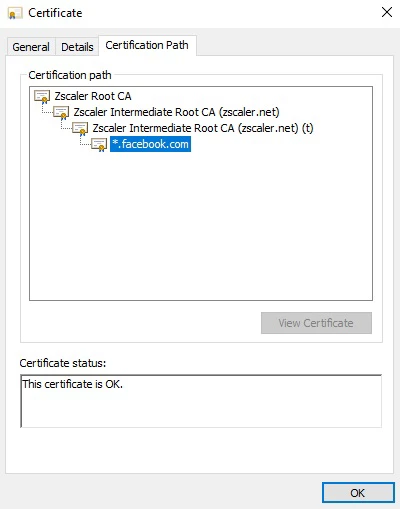

AFAIR there should be at least 2 certificates, the Zscaler Root CA and the Zscaler Intermediate Root CA, as shown in this screenshot (again picked on the Internet):

Julien D
October 24, 2025
only one is there.
 I wonder from where you get this screenshot. If from the Windows cert manager then I think it is expected since you only view the selected certificate. But if you get the certificate by clicking on the lock from a browser you may get more certificates in the chain.

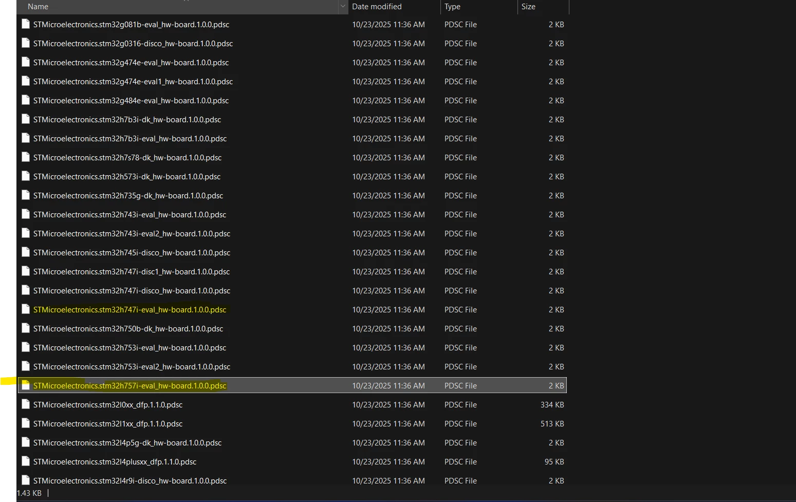

Jagan1Author
October 24, 2025
these packs available looks like is this correct?
Julien D
October 24, 2025
Packs are installed under %AppData%/Local/stm32cube/packs/STMicroelectronics/.
