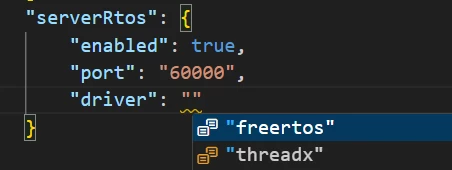

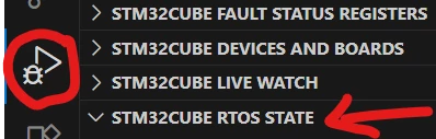

@z_dst, I confirm that only the RTOS state view in the left panel supports ThreadX.
Currently, we have two RTOS views available. This is definitely a quick win, and we have already started a full rework proposal.
The current quick win combines:
  • A home-made proof of concept (the left panel) relying on STM32CubeIDE’s (Eclipse-based) proven RTOS awareness features (called rtos_proxy), which currently supports only FreeRTOS and ThreadX.
    Please ensure proper setup is done in your launch.json.

z_dstAuthor
Oct 21, 2025 7:26 AM UTC
Thanks a lot, it works as you described, can't wait for it to be moved into the big space instead of the placeholder.

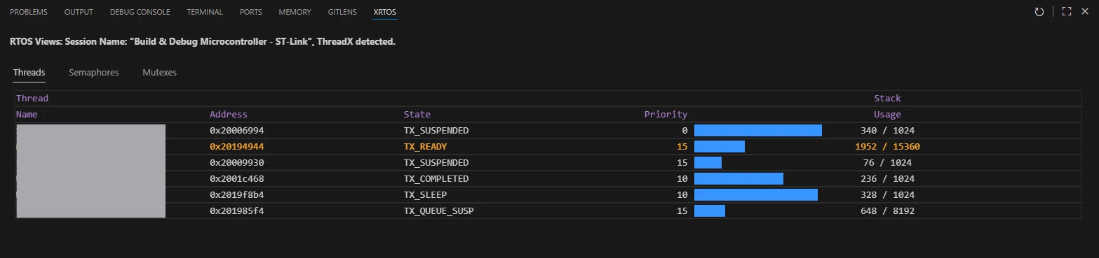

Oct 21, 2025 8:22 AM UTC
FYI, ThreadX is in the new version of rtos-views (0.0.12). Not released yet, but you can install it from the build artifact: https://github.com/mcu-debug/rtos-views/actions/runs/18654942463
z_dstAuthor
Oct 21, 2025 10:45 AM UTC
Wow good to know, thanks!
