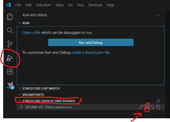

Jul 21, 2026 7:53 AM UTC
​@Engineer0815
STM32CubeCLT is no longer used with STM32CubeIDE for VS Code. STM32Cube bundles now provide all back-end components. STM32CubeIDE for VS Code is self-contained and fully integrated. No additional components are required.
To have a try resolving the error that occurs during STLINK device initialization, update the STLINK firmware.
