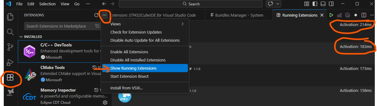

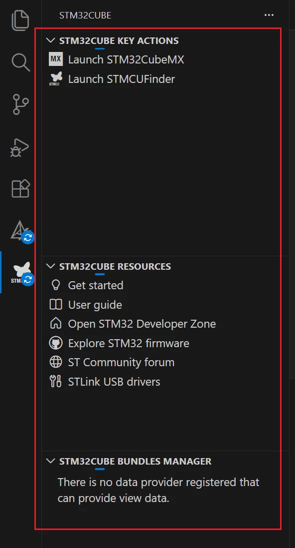

When opening a project directory in VS Code, the STM32CubeIDE for Visual Studio Code extension gets stuck in an infinite loading state (as shown in the screenshot below).
Symptoms:
  • "Go to Definition" does not work.
  • The Build Analyzer view does not appear.
  •  clicking the "Build" button still triggers a successful compilation.
  • Most dependent extensions, such as STM32Cube CMake Support, remain inactive

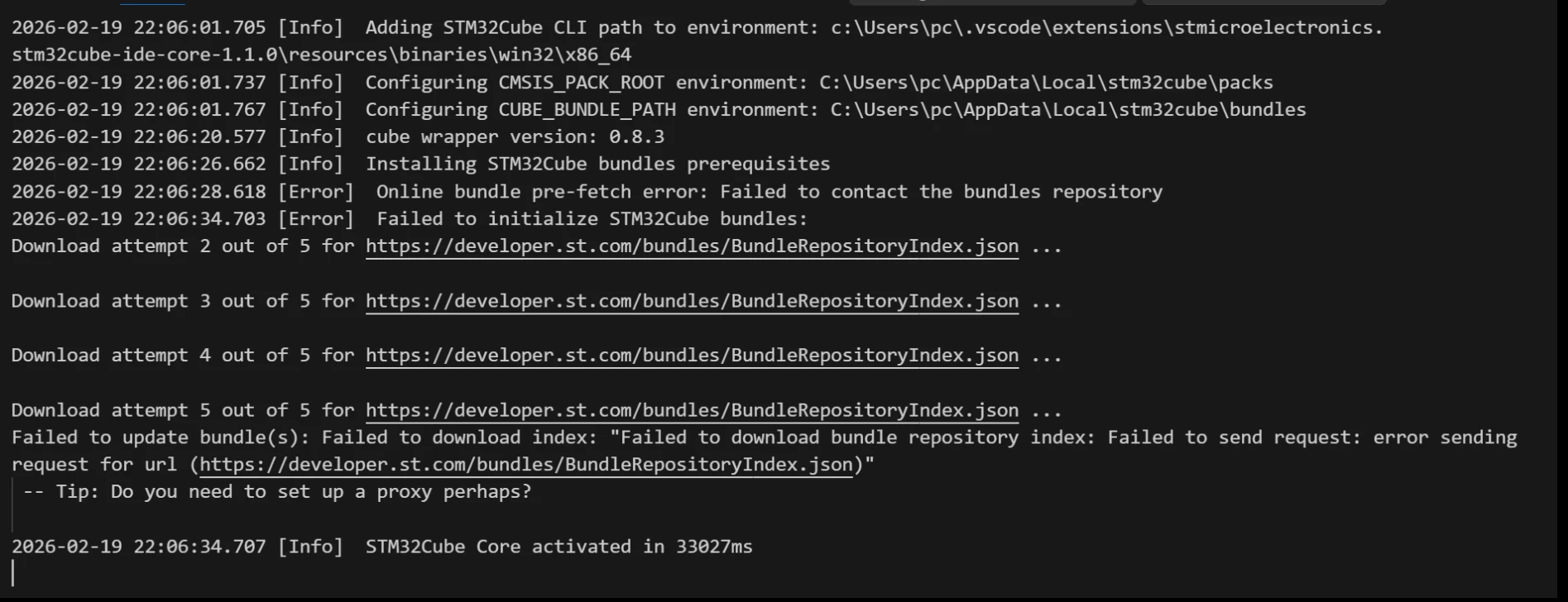

Here is the log output from STM32Cube Core during the failed loading:

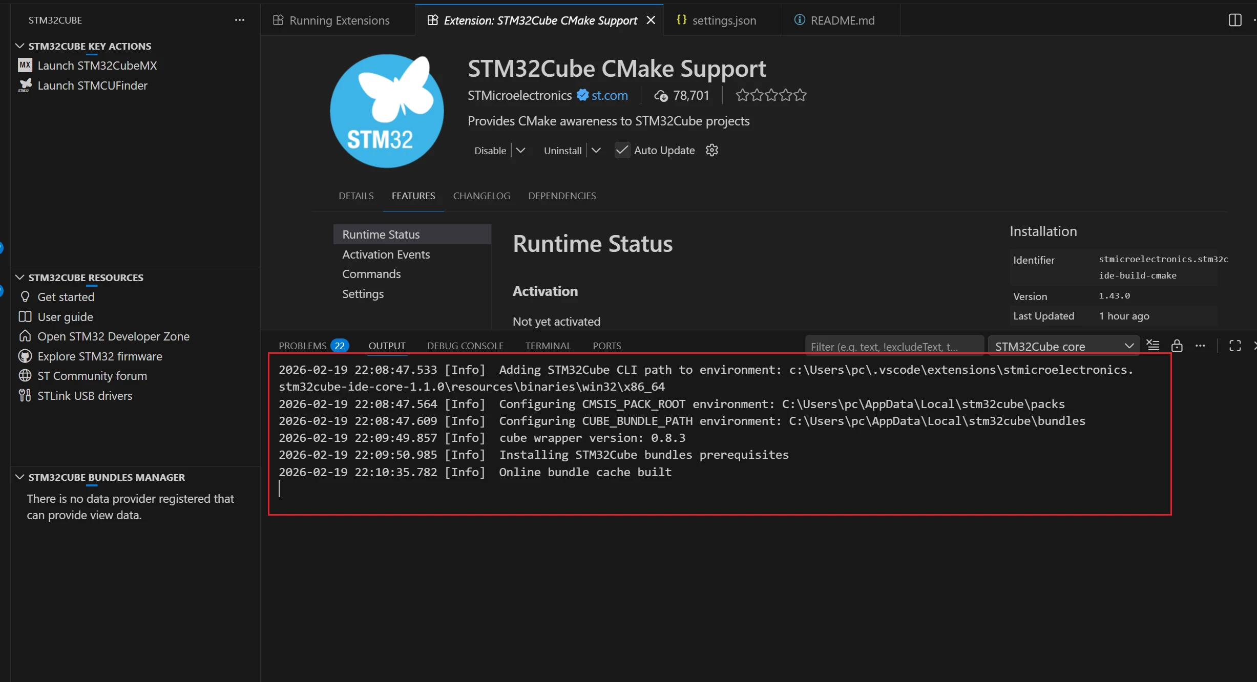

I discovered that if I completely disconnect my PC from the internet before launching VS Code, the extension reports a network error but then successfully initializes after a short period. Once initialized offline, all features (including Go to Definition) work perfectly.
Here are the logs from a successful (offline) launch:
My computer’s network connection is working fine. I tested this URL in the VS Code command line —developer.st.com/bundles/BundleRepositoryIndex.json — and it downloads normally. I’ve tried both the latest version (3.7.0) and the older version (3.6.4), but neither fixed the issue. Right now, the only way I can open it is by disconnecting my computer from the network. Is there any way to solve this problem?

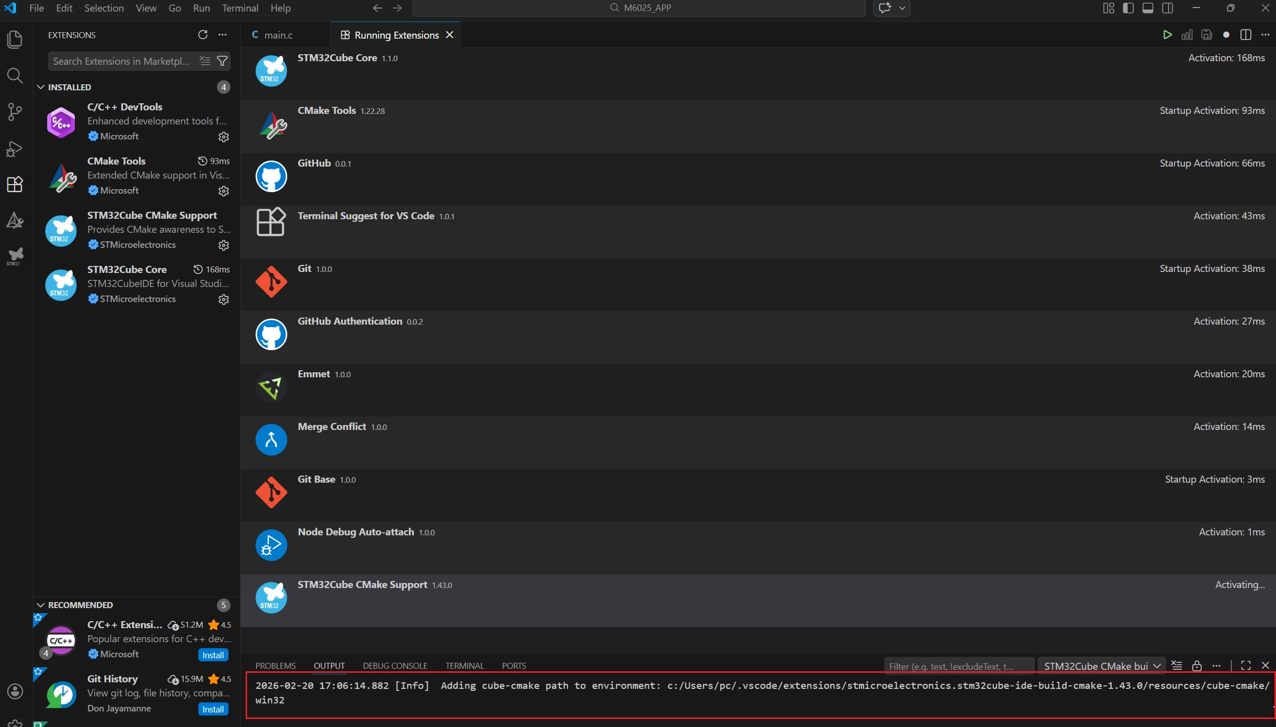

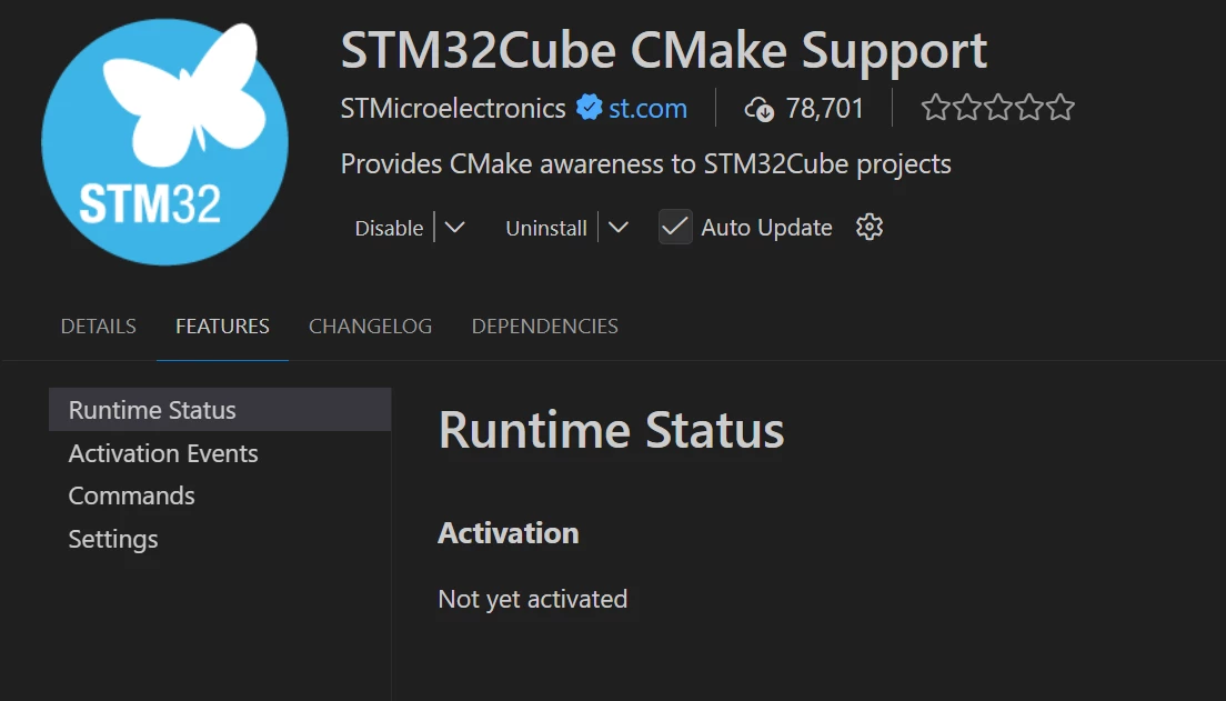

LiHuaAuthor
Feb 20, 2026 9:47 AM UTC
Thank you very much for your suggestion.I also updated my VSCode version to 1.109.5, but the issue still remains.
After cleaning my environment, I followed your steps and installed the extensions one by one. However, at step 3, STM32Cube CMake Support got stuck while activating.
I tried restarting VSCode, but STM32Cube CMake Support always stays in the “Activating” state and never finishes.
Below are its logs.
Could this be caused by a network issue on my side?
