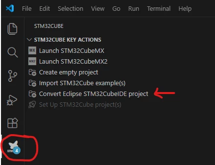

Is it possible to install STM32CubeIDE and STM32CubeIDE for VS Code on one PC (Windows)?
  If so, can I run both versions simultaneously?
    If so, can I program two microcontrollers simultaneously with two programmers?

I guess it is possible, just make sure that each of your debug configurations has a unique server port and the correct serial number.

STM32CubeIDE Eclipse and STM32CubeIDE for VS Code can coexist without issues.
STM32CubeIDE for VS Code provides a feature that converts Eclipse projects to CMake. CMake project(s) are supported by both IDEs.

Thanks a lot.
