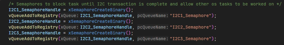

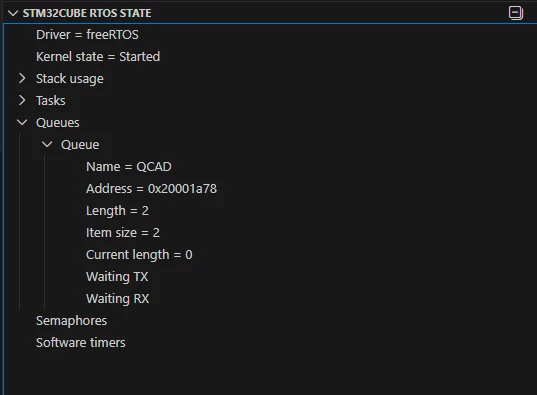

I am trying to use the STM32CUBE RTOS STATE panel within VSCode as opposed to setting a watch variable for xQueueRegistry, but the state panel does not match what is shown in the queue registry. Only the first queue is shown.
Also, I am curious how to get Semaphores to show up in the semaphores portion of the tree in the state panel. The semaphores I am using are binary semaphores which under the hood are just generic queues.

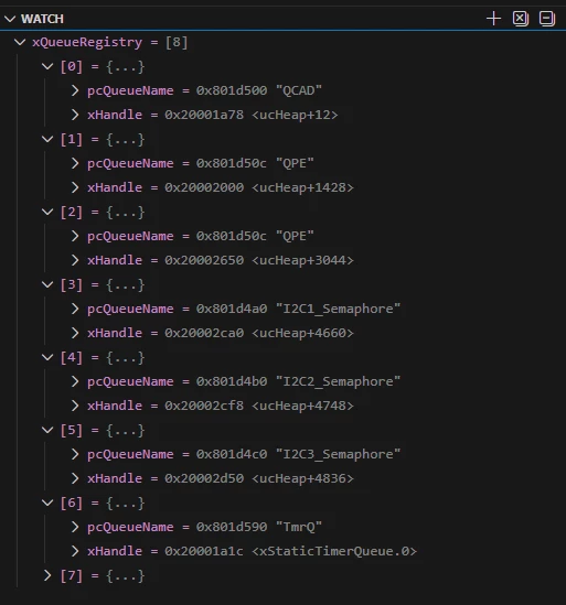

xQueueRegistrySize was not defined. So I added the following lines of code to main.c as you suggested
Optimization is set to -O0, so nothing should be optimized out. But just to be sure, I checked that I could view temp, xQueueRegistrySize and xQueueRegistry as a watch variables.
There are three entries in the registry queue, but only QCAD is shown in the RTOS State panel.

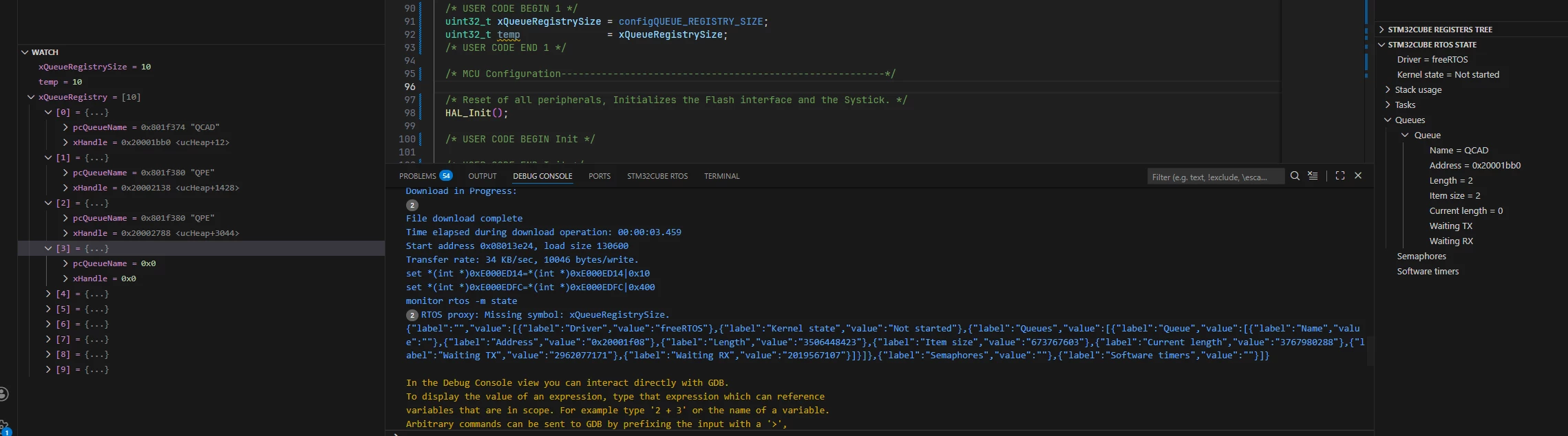

Also, after flashing of the device, I still get this message "RTOS proxy: Missing symbol: xQueueRegistrySize."
I tried adding the xQueueRegistrySize variable as a global out (outside the int main(void) entry point), but when I do so I run into a different error that prevents the debug session from connecting. I think this is a different issue that I will create another post about.
