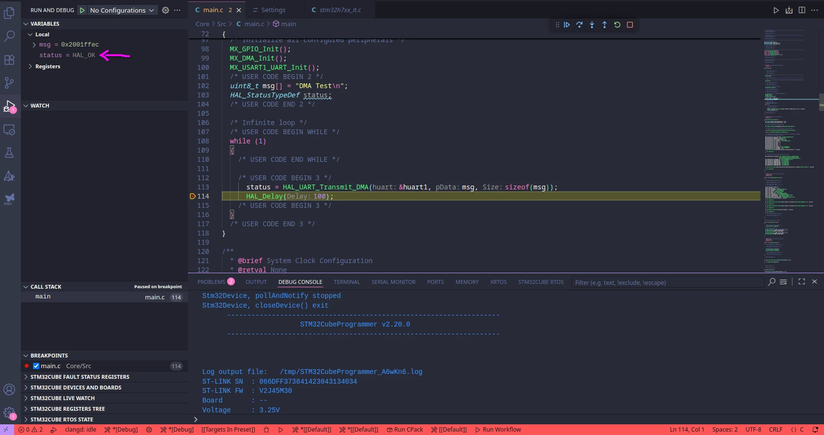

Hi all,
This is my first time posting here.

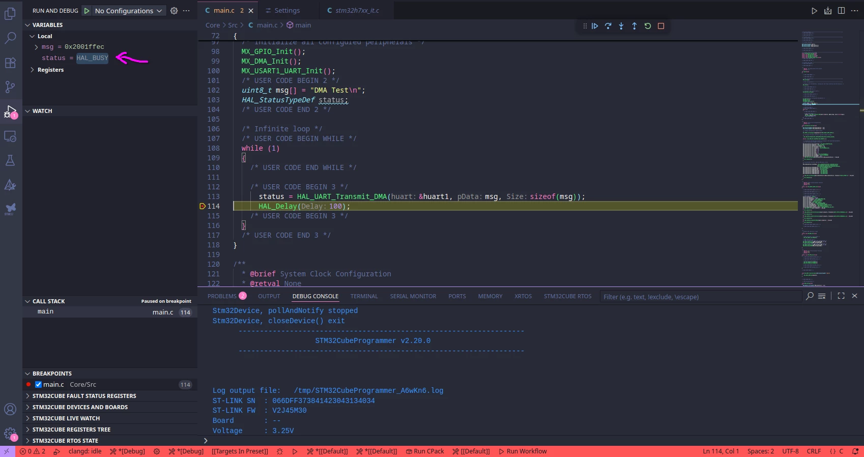

I have a problem with STM32 VSCode Extension v3.5.1 where the DMA on my STM32 H7 (STM32H725RGV6) doesnt work.
I tested this with UART TX and ADC Circular DMA mode.
The function HAL_UART_Transmit_DMA() returns HAL_OK at first, and then returns HAL_BUSY for the next calls. No data was transmitted at all recieved on the serial terminal.
UART and DMA blocking functions and with IT works fine.
The same setup with CubeIDE and with the older extension v2.5.1 works fine.
Any input is greatly appreciated.
Many thanks
Steps to replicate:
Start a new stm32 vscode project with STM32H7 like normal and enable uart1 (with all interrupts) and sw debug, max clock 550MHz with HSI.
call HAL_UART_Transmit_DMA() and it doesnt work :)

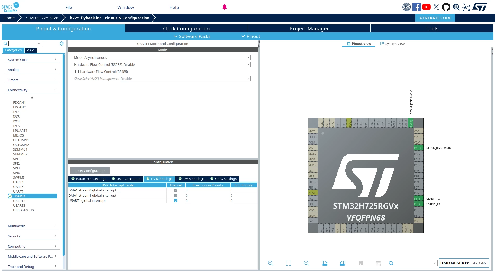

Hi @hakeem
as first analysis:
  • In your HAL_UART_TxCpltCallback(), you call HAL_UART_DMAStop(). This is unusual because the HAL driver usually stops DMA automatically after transfer completion.
  • Calling HAL_UART_DMAStop() inside the Tx complete callback might interfere with the HAL state machine. Try removing this call.
could you also share your DMA channels Config please ?
hakeemAuthor
August 28, 2025

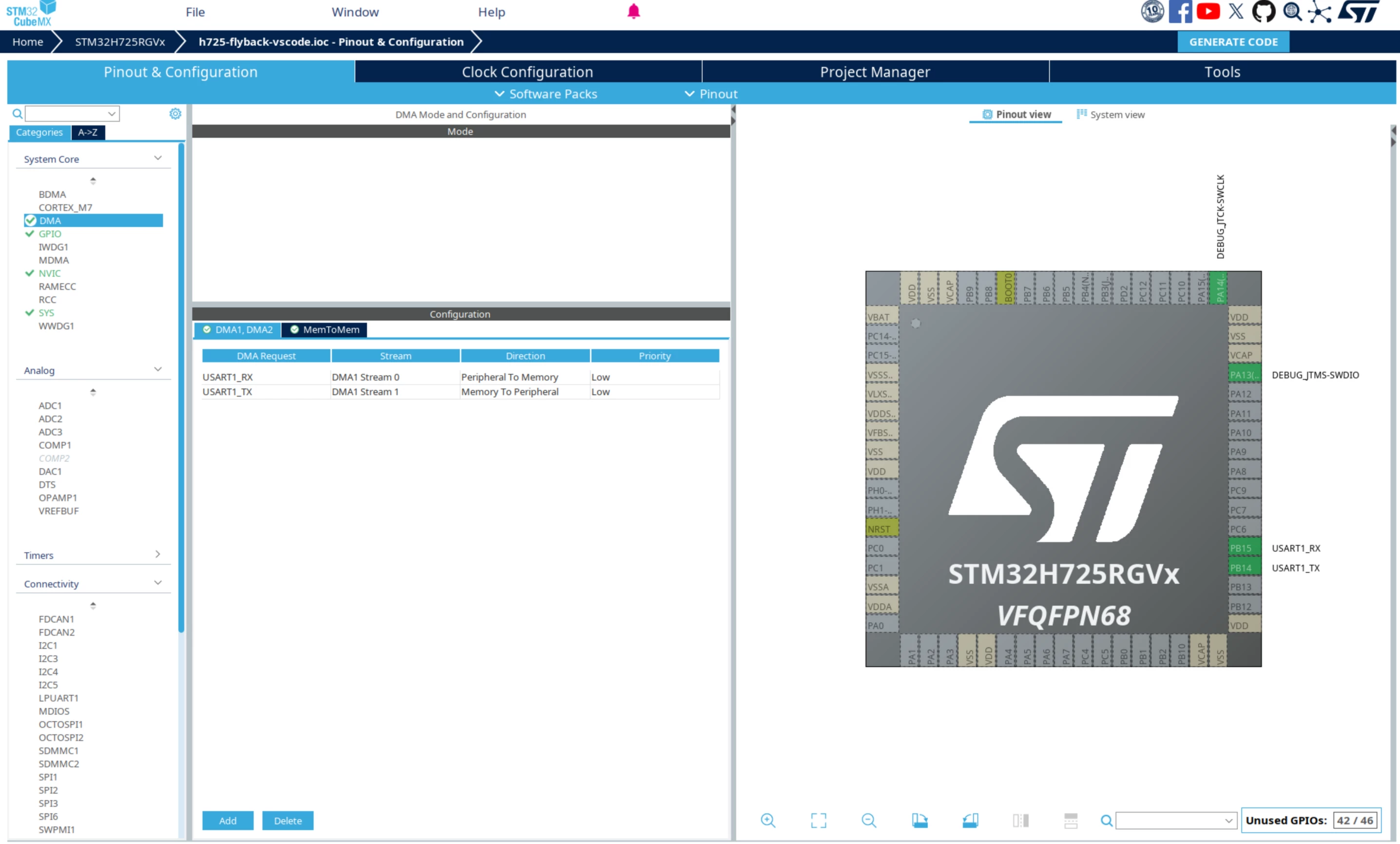

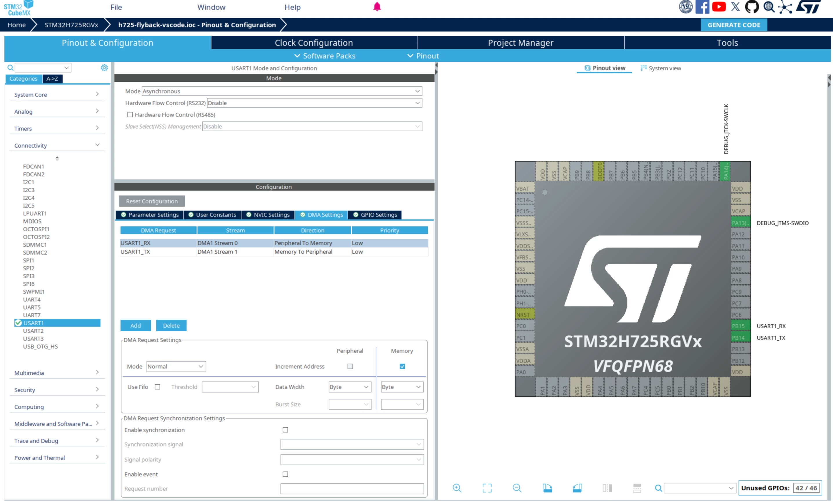

Hi @Nawres GHARBI ,
My bad, I forgot to remove the HAL_UART_TxCpltCallback() line. It was one of my attempts at debugging it.
Here are my DMA settings which should be the default settings when DMA is enabled.
Nawres GHARBI
September 1, 2025
hi @hakeem
As I don't have access to your project I propose these additional checks
A. NVIC Interrupt Priority and Enable
  • DMA1_Stream1 IRQ must be enabled and priority set (usually 0 or 1).
  • This is critical and often missed if you rely only on CubeMX generated code but then modify or migrate code manually.
__HAL_LINKDMA(&huart1, hdmatx, hdma_usart1_tx);
C. DMA IRQ Handler
  • Ensure the IRQ handler calls the HAL DMA IRQ handler:
void DMA1_Stream1_IRQHandler(void)
 HAL_DMA_IRQHandler(&hdma_usart1_tx);
Summary of What to Do Next
  1. Check your CubeMX-generated dma.c and usart.c files to verify DMA stream/channel, request, and linkage to UART handle.
  2. If you manually initialize DMA (or if CubeMX does not generate linkage), add:
  1. Ensure NVIC IRQ for DMA stream is enabled and priority set.
  2. Implement DMA IRQ handler in your interrupt file.
  3. Test the code again with these corrections.
hakeemAuthor
September 6, 2025
Hi @Nawres GHARBI
Thanks for the reply, i have checked all the above and all of them have been done CubeMX but it DMA still doesnt work.
Here is the entire codebase if you want to see it.
https://github.com/Amrlxyz/h725-flyback-vscode
But i can assure you that its basically h725 with minimal peripherals and only dma and uart enabled.
I have checked and compared with the code generated by cubeide and somehow only the one generated in cubeide works. Might be something to do with compiler settings idk
