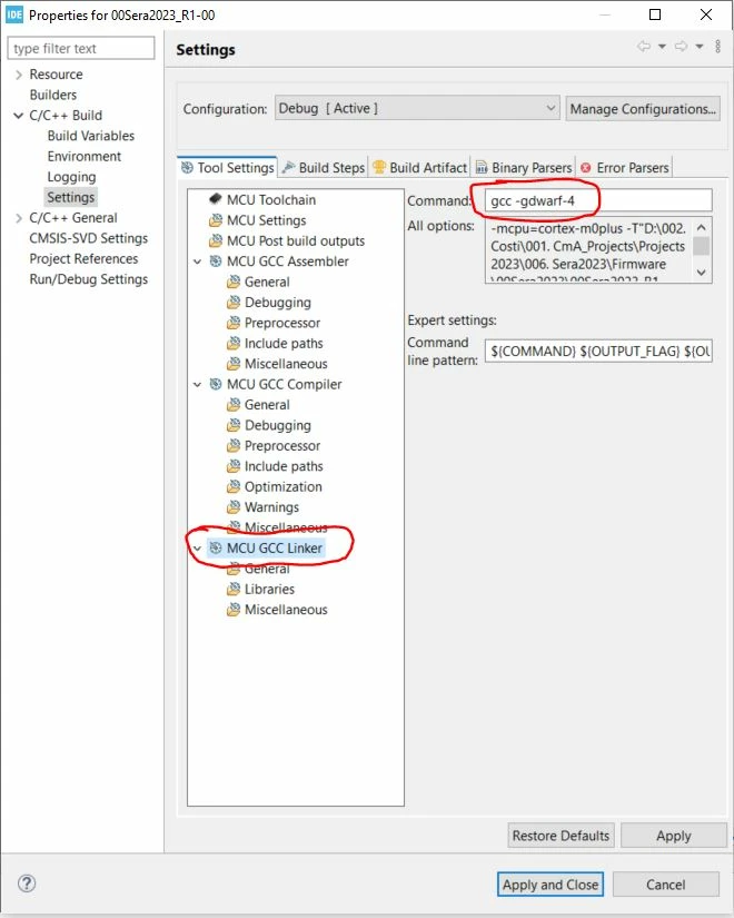

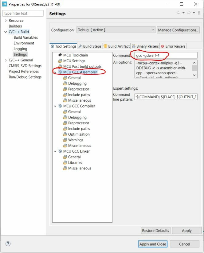

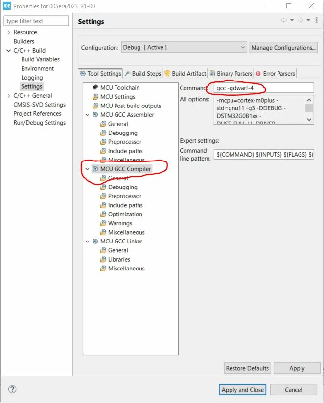

To force all compilation units to have the same DWARF version, you must specify the desired DWARF version in your compiler's compiler options. DWARF is a debugging format mainly used in compiling and debugging programs. Here's how to do it: see the 3 screenshots.

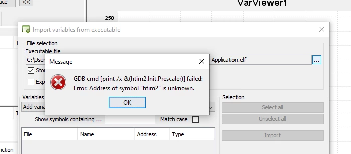

I built application with -gdwarf-4 and Studio accepted the .elf, but now it shows an error message window. Pressing Esc key shows another, and another and another an so on. There is probably one error window for every symbol in my .elf. Hundreds ? Interesting. Any idea what next ?
The Studio is not even among running tasks to kill it. Or is it ?
Thanks.
