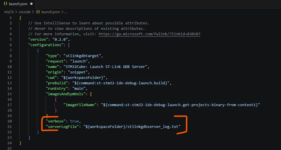

Half-kidding, but let's give us a chance to help you! Could you at least share more about the device (board) you're connecting to?
Also, could you please copy and paste the debug console trace when it fails?
(Tip: Two extra directives can be added to your launch.json file to get more details if needed.)
