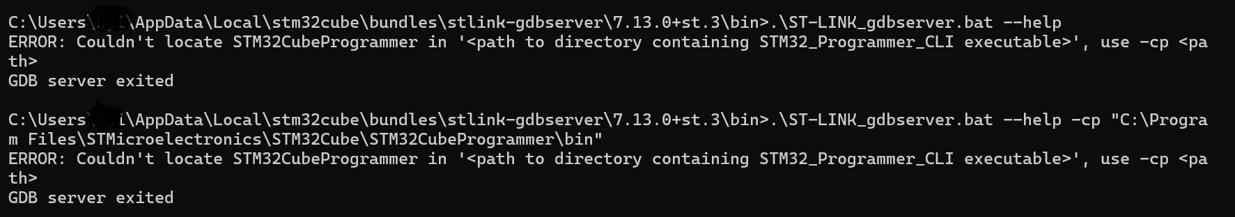

Running the bundled server manually exposes the actual error, which the extension swallows:
Note --help -cp <valid path> produces the same error — the server dies on config parsing before honoring the command line.

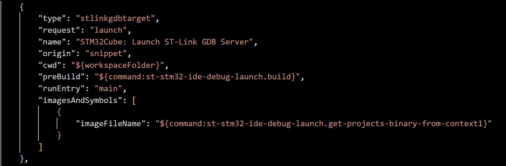

The default snippet generated by "Add Configuration… → STM32Cube: Launch ST-Link GDB Server" contains no programmer-path field, so the extension is expected to resolve and pass the CubeProgrammer path automatically when spawning the server.

  2. Add Configuration… → "STM32Cube: Launch ST-Link GDB Server" (unmodified default snippet)

  4. Run ST-LINK_gdbserver.bat manually from the bundle bin → placeholder error

  • Workaround 1 (verified): add "serverCubeProgPath": "${command:st-stm32-ide-debug-launch.get-programmer-path}" to the launch configuration → debugging works, including RTOS-aware via serverRtos. Notably this command variable resolves correctly when written explicitly.
  • Workaround 2 (verified): edit the bundle's config.txt, replacing the placeholder with correct path to directory containing STM32_Programmer_CLI executable
