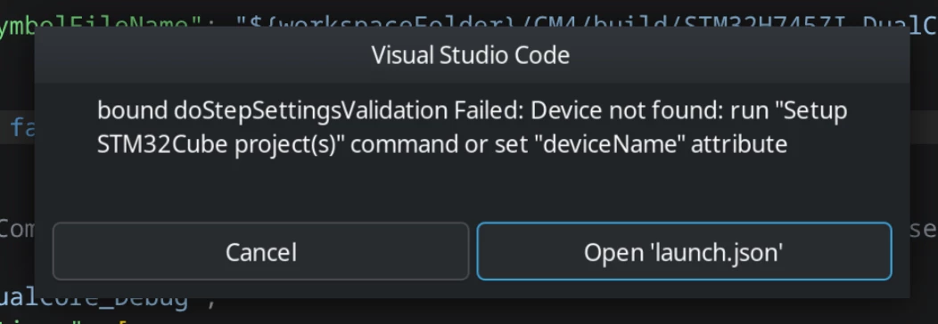

I have copied the exact launch.json used in the guide, as well as ran the Project Setup as described in the guide. I also selected “DualCore_Debug” as debug configuration. When I start to debug the code the following error occurs pretty much instantly:
bound doStepSettingsValidation Failed: Device not found: run "Setup STM32Cube project(s)" command or set "deviceName"attribute
When clicking any of the two buttons the same error pops up a second time, I suspect that’s because of the two cores, but that’s only a guess.

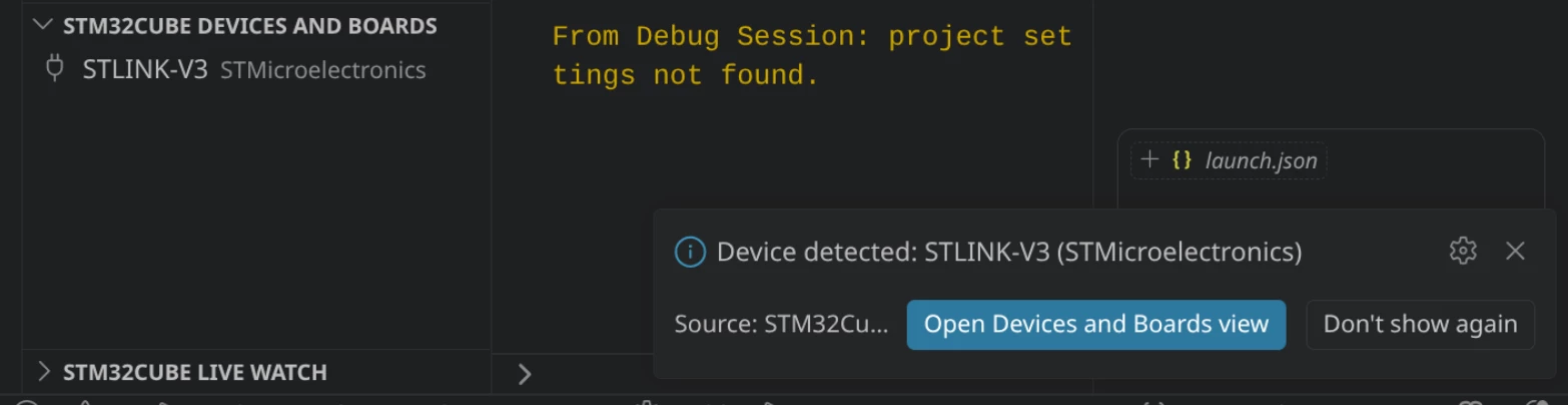

When connecting the NUCLEO-board it is being detected by the operating system and is also listed under “STM32CUBE DEVICES AND BOARDS”:
NUCLEO-Board being detected by VS Code/STM32CubeIDE

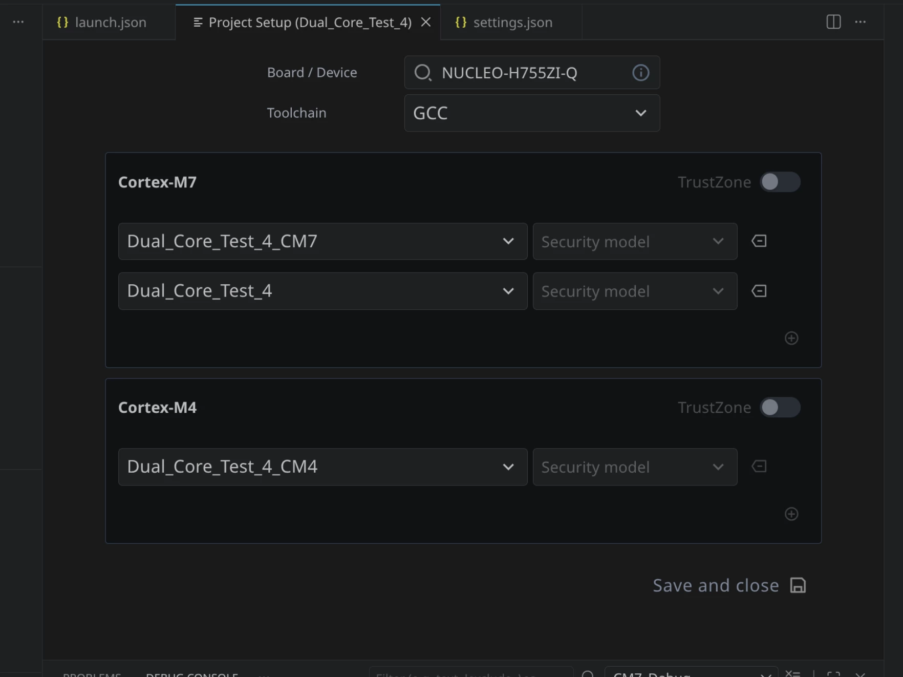

When I re-run the Project setup I see the Projects correctly assigned to each core, although for the M7 another project has been automatically added, which I did not add myself:
Porjects being assigned to each Cortex-Core
Even when I remove the “Dual_Core_Test_4”-Project from the Cortex-M7 and click “Save and close”, it will reappear next time I run the Project Setup.

Edit: I forgot to mention, the same error message also appears when the NUCLEO-board is not connected to the computer.

Regarding the “second project” for the Cortex-M7 in the configuration Setup panel, there is indeed a bug that is currently being fixed. However, it should not affect debugging.

Have you updated the binary paths in your debug configuration?
Because in the guide’s launch.json, it is: ${workspaceFolder}/CM4/build/STM32H745ZI_DualCore_Example_CM…
But the binary name of your project may be different.
/Flo

Thanks, that’s a good catch. No, I didn’t change them, that was certainly a problem. I did change the lines to
"imageFileName": "${workspaceFolder}/CM4/build/Dual_Core_Test_4_CM4.elf" // Loads the CM4.elf image
and
"imageFileName": "${workspaceFolder}/CM7/build/Dual_Core_Test_4_CM7.elf" // Loads the CM7.elf image
in all three cases (two lines for the CM7_Debug and one for the CM4_Debug).
When running the debug the error no longer persists and I am able to start the debug session and step through some of the startup code. But after some time I get various error messages. Most of the time I receive the message “bound doStepConnectToTarget Failed: could not connect: Connection timed out.” The errors are very different with each restart of the debugging session, I can’t make out any pattern. I can give further information if neccesary.
