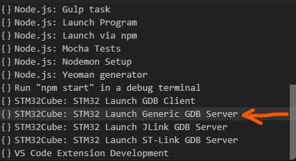

Pending answer from STM, be aware a more free but less automated debug configuration is supported:
Most probably you can pass here all parameters you want to JLink GDB server.

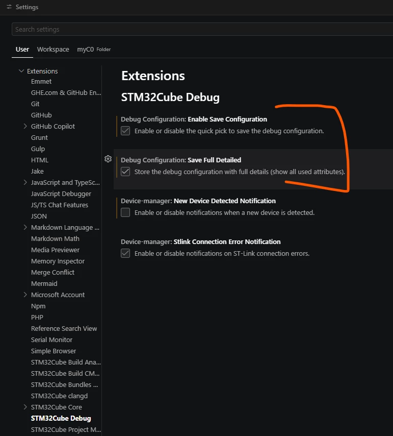

Possibly too as alternative or help :
At first launch it will save for you a resolved configuration you can take as inspiration or to hack possibly.

Nope. This generic launch configuration is part of STM32CubeIDE for Visual Studio Code extension pack.
Such said it is served by a dedicated extension.

Doing résolve launch configuration is just to get inspiration from. In real it exposes what the tool is doing behind the scene. So yes it should comfirm your missing parameter is not used.
Non automated/free generic one is a template to be filled fully by you. Because no process applied on top of what you are going to write is what is going to be executed. This generic is doing no assumption at all. The first is you can ask for any gdb server and any of its native parameter.
