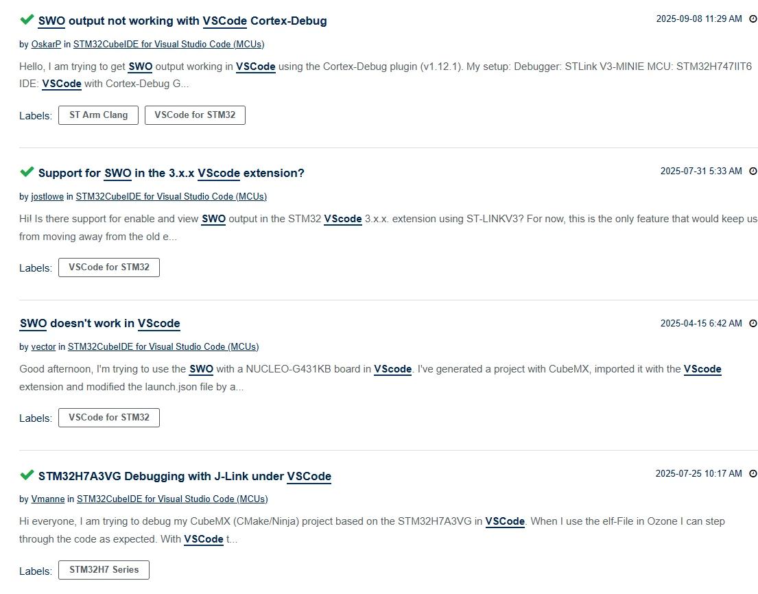

Hi everyone,
I’ve spent the last few hours troubleshooting SWO (Serial Wire Output) trace within VS Code. I know this is a recurring issue in the forums, and while ST employees have mentioned they are working on a native implementation, I wanted to share a solid workaround that is currently working for me.
It’s a bit tricky to set up the first time, but once you have your launch.json and OpenOCD paths configured correctly, it works great.
