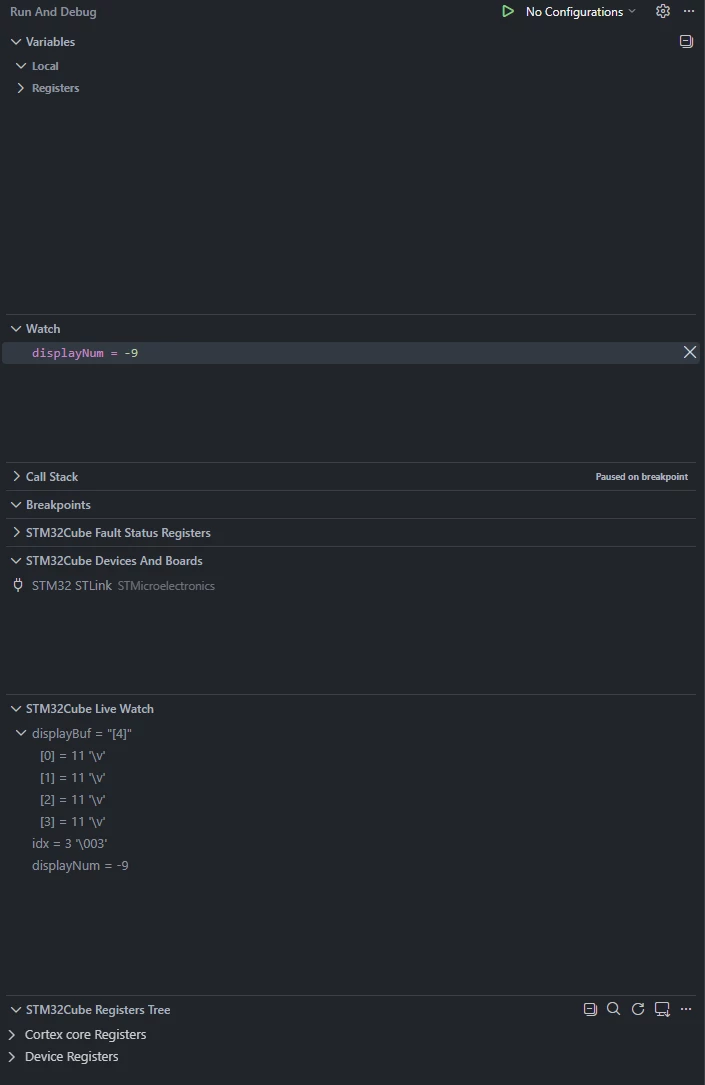

How to edit variables when debugging in VS Code
I can view the variables concerned either in Watch and Live Watch window, but i have no way to edit them. In Watch window, double-click only allows me to edit the expression instead of its value. VScode document says I can edit variable value in “Variable” window, but i can’t see global variales there.
1 reply
Nawres GHARBI
Nov 2, 2026 9:56 AM UTC
Hi ​@CES5209
give a try to our live watch
 "liveWatch": {
                "enabled": true,
                "samplesPerSecond": "4"
