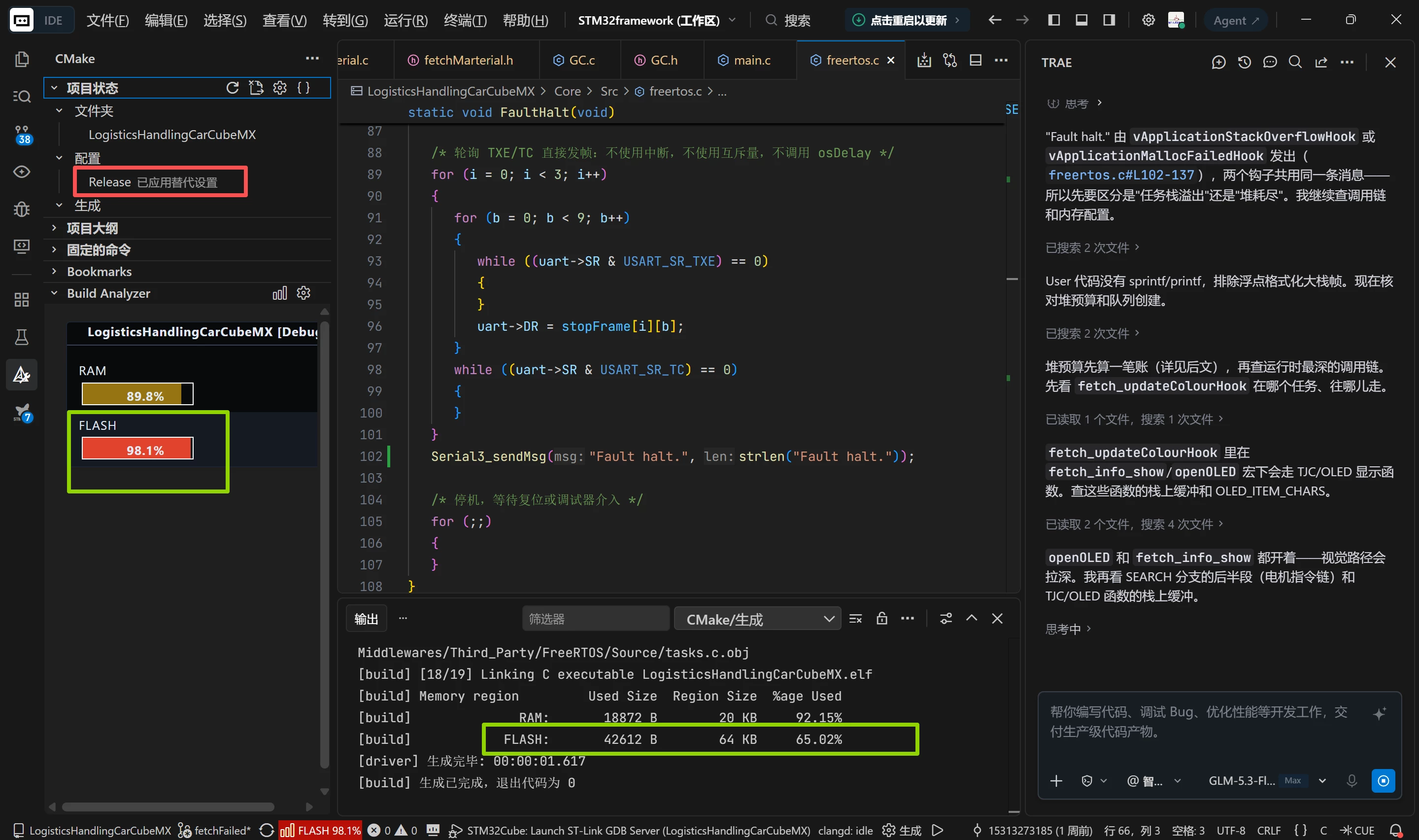

How to apply release 配置 in STM32Cube for vscode , rather than debug 配置
In release configuration, the flash usage is 65%,but in debug configuration, it is 98.1%. What’s more ,when i download my app to stm32f103c8t6, it will be debug configuration.

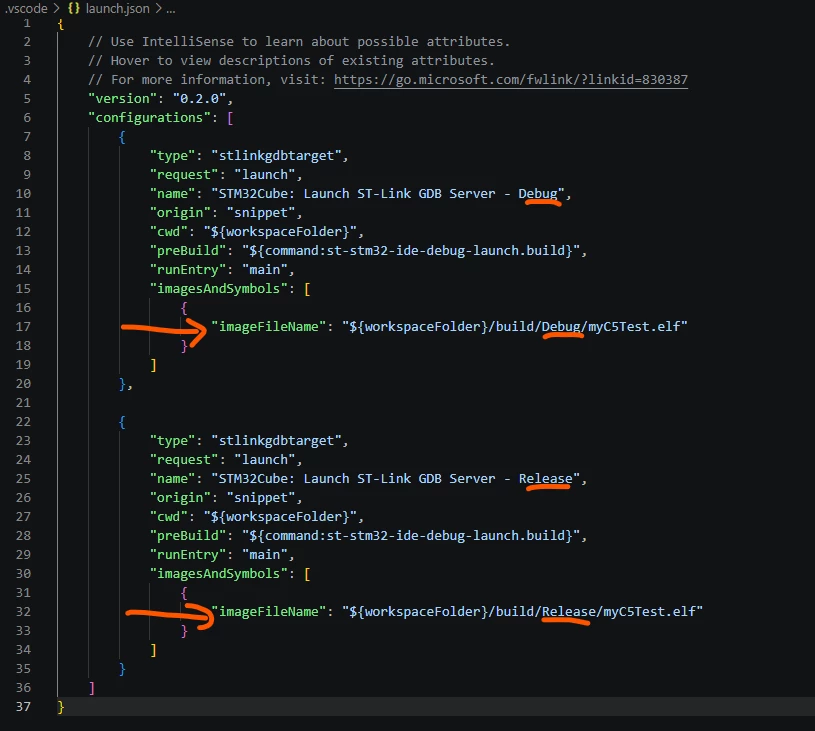

Not sure to fully understand what your question / issue is.
What I can say is no surprise Debug configuration binary is larger than Release one. Rational about is Debug configuration is preventing lot of compiler optimization to ensure best debug experience ensuring a one to one match to source code.
Such said you can flash the binary you want on hardware target.
Either be explicit as part of your launch.json:

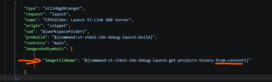

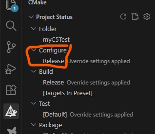

Or let’s the tool act for you:
it will pick the binary being the one of your active CMake context dynamically:
