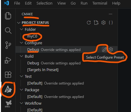

How do I create debug and release profiles for a project?
So I have an STM32 project in VSC and when I first set up this project and started debugging, I vaguely remember being asked by VSC to create a launch.json file.
Now it seems I can build a ‘debug’ session, and launch it, and debug with all the usual features like step-in, step-out, continue, and so on. But how do I now add a ‘release’ build, which strips debug info and allows me to program a device without debugging it?

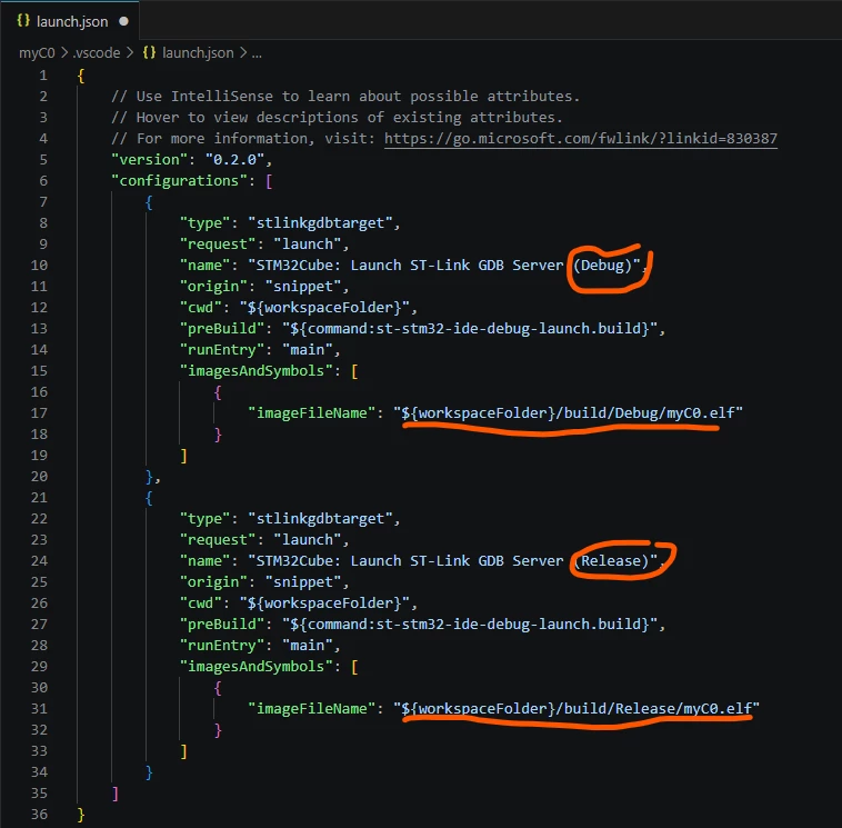

My launch.json looks like this:
// Use IntelliSense to learn about possible attributes.
// Hover to view descriptions of existing attributes.
// For more information, visit: https://go.microsoft.com/fwlink/?linkid=830387
"version": "0.2.0",
"configurations": [
"type": "stlinkgdbtarget",
"request": "launch",
"name": "STM32Cube: Launch ST-Link GDB Server",
"origin": "snippet",
"cwd": "${workspaceFolder}",
"preBuild": "${command:st-stm32-ide-debug-launch.build}",
"runEntry": "main",
"imagesAndSymbols": [
"imageFileName": "${command:st-stm32-ide-debug-launch.get-projects-binary-from-context1}"

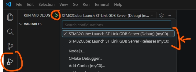

Jul 27, 2026 7:14 PM UTC
​@KMill
Thanks this line
used binary (flashed one) at debug session launch time is dynamic.
It relies on your active project context. Active context is mastered by CMake Tools extension:
Elect the one you want to shoot for !
If you dislike this you can just hard code kind it:

​@alikhan
CMake is your best friend. Full flexibility is ready for you. Let's rely on CMakePresets.json file.
Ps: no GUI available. Edit mode is the way of working.
Note: Have a try to generate a so called empty project. You will get an template kind.
