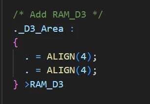

I am new user of stm32h750, and I try developing it with STM32 vscode extension, it is great!
For sci_dma, I need a buffer at RAM_D1(@0x24000000) , how can I define the array?
I can only define a pointer at the address and it works:
uint8_t *p = (uint8_t *)0x24000000;
But how about a char_buffer[n]?
Please kindly help me, thank you.

in STM32H743IITx_FLASH.ld
add
._D1_Area :
 . = ALIGN(4);
 . = ALIGN(4);
} >RAM_D1
 and
__attribute__((section("._D1_Area"))) float char_buffer[n] = {0};
Sorry, I overlooked something.

try like
__attribute__((section("._DTCM_Area"))) float adcBuf[3] = {0};
__attribute__((section(".RAM_D1"))) float char_buffer[n] = {0};
