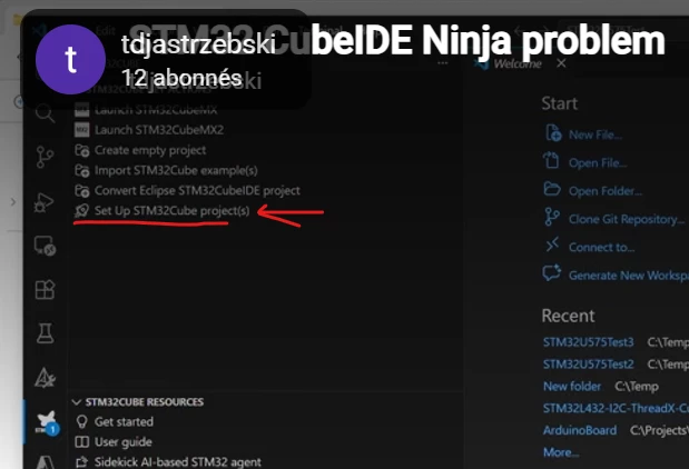

Sounds weird you had to install bundles by yourself. Installing extensions is leading to a notification in the right bottom corner to manage this.

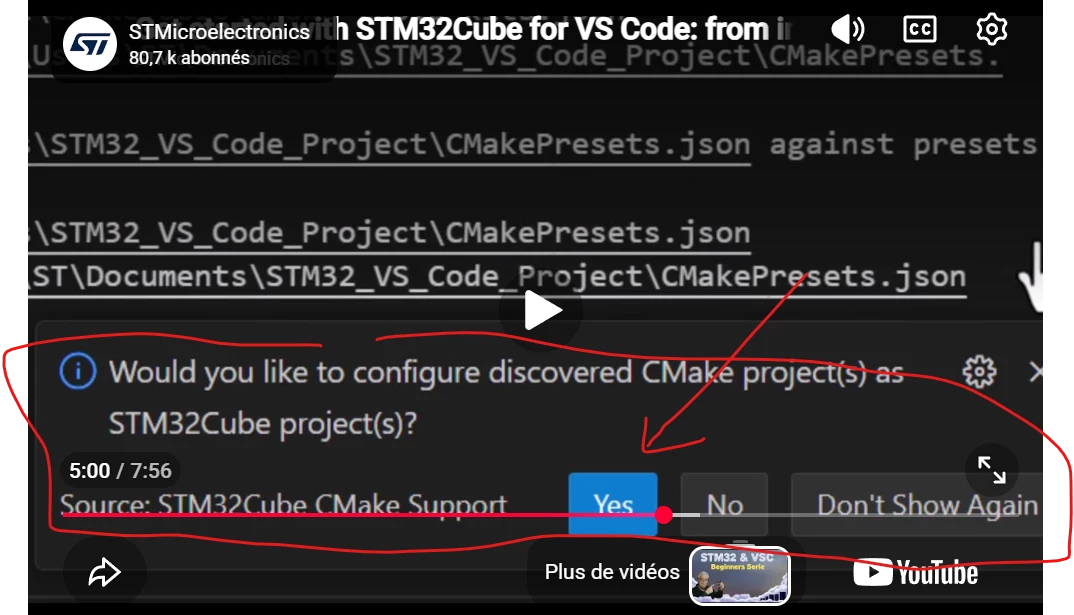

Same sounds you have missed a notification then adding your project to workspace. You have to accept enriching it as a STM32Cube project. This process setup it right enabling proper tooling to edit build and debug.
You can this process explicitly thanks dedicated key action so called "Setup project"

Graduate II
Jul 25, 2026 7:00 PM UTC
​@TDJ
See

​@TDJ
Thanks for sharing video. Unfortunately lacking THE key step about folder addition to VS Code workspace.
Looking at yoiur explorer view I can confirm project setup is not completed to no say not executed at all. All your pain is due to.
Your project is going to be a STM32Cube project - having so all proper tooling like cmake and ninja set - if .settings folder is created at your folder root. Here I can see .vscode but that’s all and it’s not enough. .settings folder has to host x3 files at the end.
I suggest back to invoke project setup
or to remove your folder from workspace and add it back taking care about the magic notifcation then

TDJ
TDJAuthor
Senior III
Jul 27, 2026 8:32 PM UTC
Yeah, thank you - it worked! That was the piece I was missing.
It might be a good idea for the STM32Cube extension to ask whether the user wants to configure the project when it detects a suitable project structure, such as a .mxproject file and a CMakeLists.txt file.
