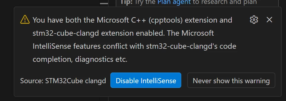

Disable Intellisense: You have both the Microsoft C++ ...

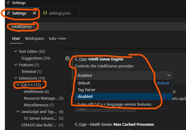

Hi ST,
I understand that CubeIDE (clang-based) code-completion cannot coexist with Microsoft C++ IntelliSense. However, it seems that once IntelliSense is disabled (which is presented as the default option), it also stops working for other non-STM32 C++ projects permanently.
I wasn’t able to figure out how to re-enable it, disabling Cube IDE extension was not helpful. After about 30 minutes of trying, I ended up reinstalling VS Code- which probably isn’t the best or recommended solution.
Moreover, it looks like Cube IDE extension modifies default use settings. Even after disabling Cube IDE extension code colors look much different than originally, and code formatting does not work.
What is the proper way to handle this situation? I really would like to use Cube IDE extension but only occasionally.
Please do not alter my default VS code settings for C/C++!
Thanks,
Thomas

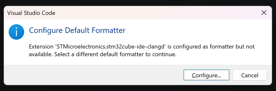

Here is the message I get trying to format other, non-cubeide project C code after disabling cube ide extension.

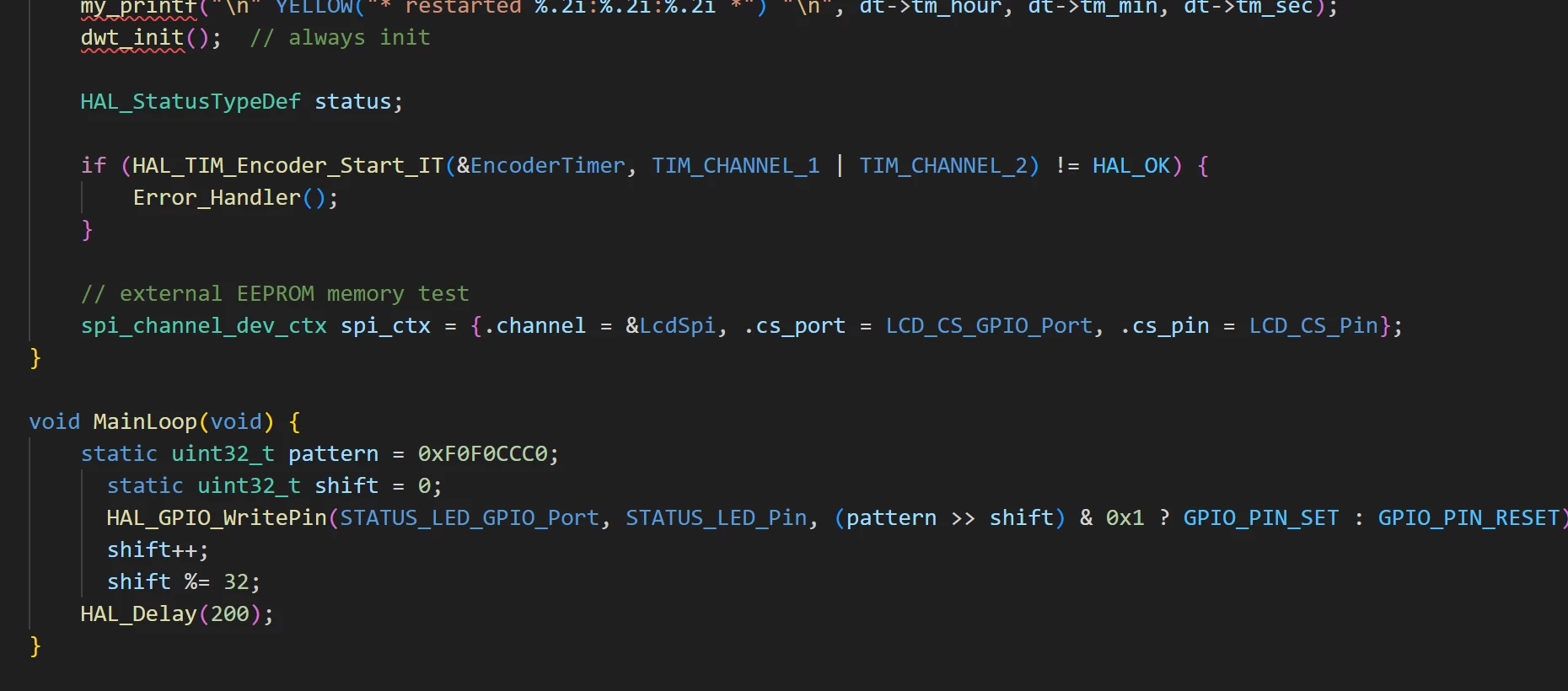

Here is how code colors look

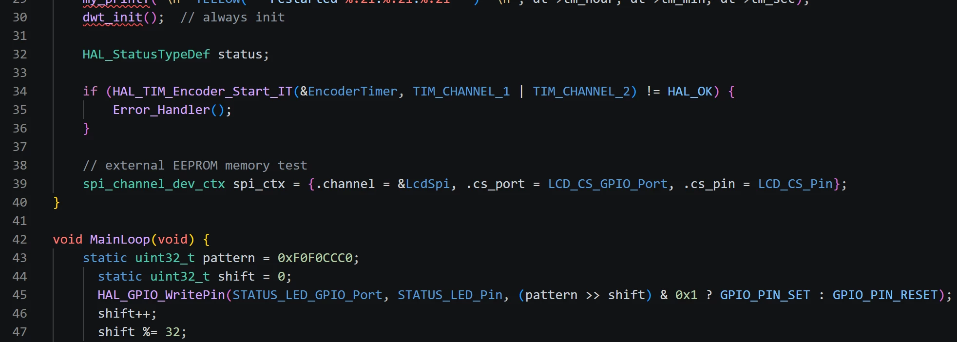

.. and here is how it used to look

vincent_grenetBest answer
March 29, 2026
@TDJ
STM32CubeIDE for Visual Studio Code promotes clangd as the default tool for code indexing. However, you are free to not install or to uninstall the extension that provides this functionality. No dependencies are enforced.
Currently, we also recommend including settings in the .vscode settings file to support the Microsoft C/C++ code indexing solution.
The rationale for promoting clangd first is that it is fully open source, while the Microsoft solution is not. Because clangd is open source, we can contribute bug fixes and improvements. Additionally, clangd enables support for Visual Studio Code alternatives such as Codium, Theia, and Antigravity, which the Microsoft C/C++ extensions do not allow.
Clangd linter usage is currently disabled by default in the contributing extension settings. Clangd is a multipurpose tool; our primary interest is code indexing. Valuable extensions are available on the marketplace to address formatting, linting, and other tasks. We prefer to allow freedom to the end user.
CMake and GCC versions are not restricted, but STM32CubeIDE for Visual Studio Code manages them through the STM32Cube bundle system.
Multiple CMake and GCC versions are currently supported, but not all possible versions it's true. If a specific version is missing, share the version and ST may assist.
You can contribute to your own local bundle, which the system considers. An STM32Cube bundle is a package for distributing any data or binary set. It is a zip file containing content and a mandatory CubeBundle.json file.
If you have already pulled content to your local disk, you can promote your own bundle. Once completed, your material is fully usable by STM32CubeIDE for Visual Studio Code, just like any ST's official bundle.
This is why VS Code has profiles. You can create a new profile for CubeIDE and install there only compatible extensions.
Cartu38 OpenDev
Graduate II
March 27, 2026
@TDJ
Way to get back Microsoft C/C++ is Thanks settings
Such said @Pavel A. advice is best to me; let's rely on profiles ! https://code.visualstudio.com/docs/configure/profiles
