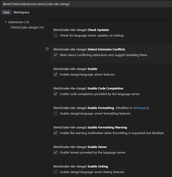

Hey --
  We would like to include a minimal version of .clang-tidy in our VS Code STM32 project. We use the STM32Cube clangd extension (through the STM32CubeIDE for Visual Studio Code Extension Pack). From our research it appears support for .clang-tidy is not currently included the STM32 fork of clangd. This request is to include that support.😎
Β  Our expectation is that by adding a .clang-tidy file to the project root and --clang-tidy to the .vscode/settings.json (snippet shown below) we would begin to see output in the β€œProblems” tab and squiggles in the code base as we edit.
~DigitalNomad
{root}.vscode/settings.json (Win11)
"stm32cube-ide-clangd.arguments": [
Β  Β  Β  Β  "starm-clangd",
Β  Β  Β  Β  "--compile-commands-dir=${workspaceFolder}/build/Debug",
Β  Β  Β  Β  "--clang-tidy",
"--enable-config",
"--background-index",
"--completion-style=detailed",
"--header-insertion=never",
Β  Β  Β  Β  "--query-driver=C:/ST/STM32CubeCLT_1.22.0/GNU-tools-for-STM32/bin/arm-none-eabi-gcc.exe"
{root}.clang-tidy:
Checks: >
Β  -*,
Β  bugprone-*,
Β  readability-*,
Β  clang-analyzer-*,
Β  misc-*
WarningsAsErrors: ''
HeaderFilterRegex: '.*'

See STM32Cube clangd extension settings. Integrated tidy features are disabled by default but you can enable them. Light tidy features are part of clangd executable in real; Maybe good enough to you ?
DigitalNomad
Oct 6, 2026 6:16 AM UTC
​@Cartu38 OpenDevΒ could you send me a screen shot for the clang-tidy setting? (I’m not seeing a specific β€œtidy” option):

You have found the place to be. Consider enabling linting capabilities.

It works ​@Cartu38 OpenDevΒ -- squiggles and Problems everywhere! Thank-you.πŸ––πŸΌ
