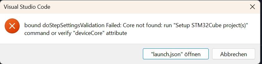

Hello, after updating to 3.7.0, my system no longer works. I can't debug and now get an error message. It was still working an hour ago.

ok What helped me was
“deviceCore”: “Cortex-M7,”
unfortunately there are no suggestions, so you don't know what form it needs to be in.

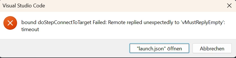

Unfortunately, it still doesn't work smoothly with two NUCLEO BOARDS H7S3L8. I always have to start board 2 first, then board 1, otherwise I keep getting this error message. However, if I start board 2 first, then board 1, it works.
Reading symbols from d:/Projekte/Test/Cube/Board2/Test/Boot/build/test.elf...
Exit.
cube has exited with code 0Ignoring packet error, continuing...
warning: unrecognized item "timeout" in "qSupported" response

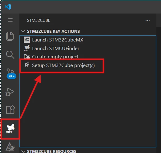

Your first error indicates that the device core cannot be found automatically.
The project setup was likely incomplete. Therefore, please execute the command "STM32Cube: Setup STM32Cube project(s)" via the command palette or thanks to the menu in the STM32Cube activity bar (recommended solution):
Alternatively, you can add the "deviceCore" attribute with the value Cortex-M7 in your case.

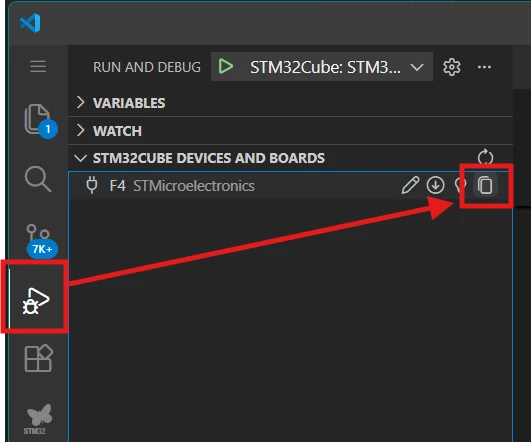

Concerning the multiple boards connected, you need to specify the serial number using the attribute
"serverSerialNumber": "<the serial number>",
the serial number can be copied in the "STM32Cube Devices and Boards" view here:
Without the serial number attribute, the debug session cannot determine which board is the correct one.

While developing today my system suddenly stopped being able to start the debugger. I suspect this is due to VSCode updating the extension to 3.7.0. I get the same error as Paul above:
bound doStepConnectToTarget Failed: Remote replied unexpectedly to 'vMustReplyEmpty': timeout
The debug console shows:
Reading symbols from PATH TO elf...
I only have a single STLink connected, and have tested two individual board (one custom, one STM32F411E-DISCO).
Any clues to what could fix this issue?

I got my debugger working by:
  • Uninstalling all ST programs from my machine
  • Uninstalling VSCode extension
  • Reinstalling VSCode extension
  • Updating ST-Link firmware
