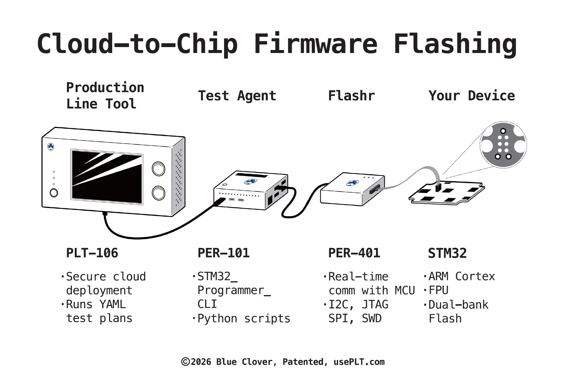

Blue Clover builds the Production Line Tool (PLT), an Arm Linux device that connects to PLTcloud for remote orchestration. One PLT sits at each test station, and PLTcloud coordinates the fleet across a customer’s line.
PLT works alongside Test Agent, a second Arm Linux device purpose-built to host third-party software directly at the point of test. It replaces the general-purpose x86 PC with something simpler and more reliable, built for exactly this job.
Because much of the hardware Blue Clover and its customers build is based on STM32 microcontrollers, including the STM32L0 Cat.5 family, STM32CubeProgrammer’s CLI (STM32_Programmer_CLI) has always been core to how Test Agent programs and validates hardware during bring-up and test.
The gap: Until recently, STM32_Programmer_CLI had no native aarch64 Linux build. Blue Clover’s workaround was OpenOCD: functional, but not the ST-validated tool built for STM32 targets, and not something the team wanted to depend on long term.
The fix: Linux Arm 64-bit support in STM32CubeProgrammer. With the 2.23 release package, the footprint was slimmed down specifically for constrained targets such as SBC/SD card deployments. That matters when the host is a single-board computer on a test fixture, not a workstation.

    • STM32_Programmer_CLI now runs directly on Test Agent, the Arm Linux device hosting the test sequence at the point of test, alongside PLT. Flashing runs on hardware designed for the job, not on a repurposed desktop PC.

But the “Test Agent” box does not have the SWD interface. The SWD is on the “Flashr” box, connected to the former, likely, over USB. Does the Flashr expose a ST-LINK compatible USB device to the “Test Agent”, or does STM32_Programmer_CLI use DFU protocol on this setup?
