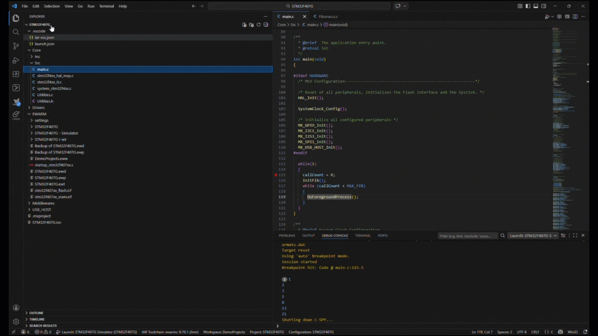

If you are building STM32 projects in VS Code, you can do that without leaving your workflow.
STM32Cube for VS Code brings together C/C++ editing, CMake and Ninja builds, Git, and one-click debugging. It also helps teams stay flexible across IDEs and operating systems while keeping CI/CD workflows consistent.Once your STM32 project is running in VS Code, the IAR C-SPY Debug extension adds a professional-grade analysis layer that scales with project complexity. C-SPY is IAR’s advanced debugging and analysis engine for embedded systems.

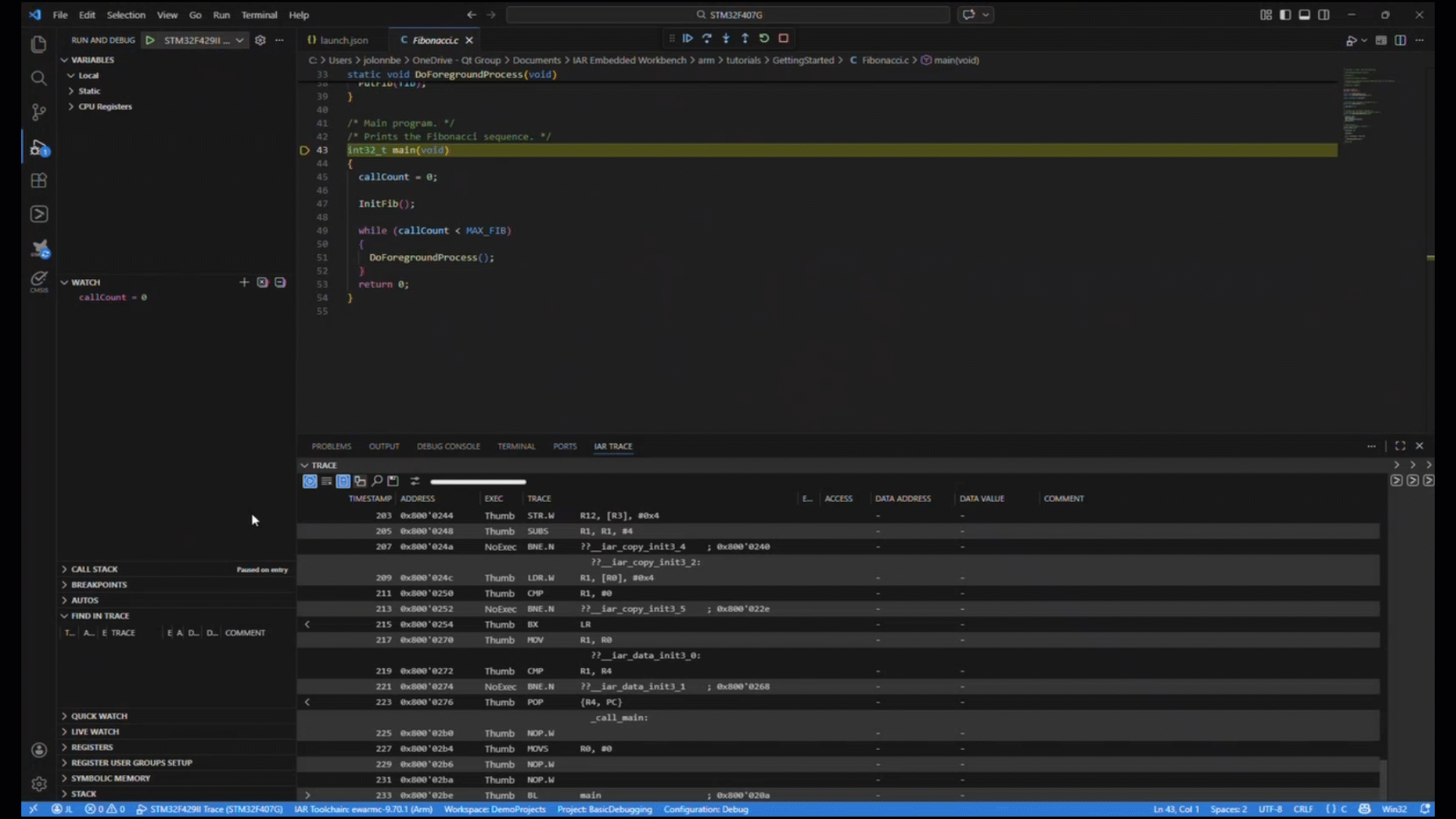

From debugging to system insight
IAR C-SPY goes beyond breakpoints and variable inspection.
With Listwindows, you get a live, spreadsheet-like view of your running target, including:
  • Core registers and custom register groups
  • Symbolic memory with direct variable navigation
  • Live Watch
  • ETM/SWO trace
  • Functional profiling
  • Real-time code coverage
That means you can move from stopping code to understanding system behavior.

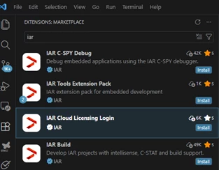

Install and configure
Install the extension from the VS Code Marketplace (@publisher:IAR) and set up the IAR toolchain for Arm. A free evaluation of the IAR Embedded Workbench for Arm is available.
A minimal launch.json configuration for the C-SPY Simulator sets "driver": "Simulator" with --cpu=Cortex®-M4 and --semihosting. Switching to real STM32 hardware is a second configuration with "driver": "ST-LINK", your device (for example --device=STM32F407VG), the matching .ddf file, and --drv_interface=SWD. driverOptions supports the full C-SPY command line with autocomplete inside VS Code.
Real-world debugging examples
  • Peripheral issues: create a custom register group (for example SPI), run the application, and see which register or bit changed, and when.
  • Memory corruption: monitor variables in Symbolic Memory to catch pointer issues, buffer overruns, stack problems, and RTOS anomalies
  • Fast bugs: enable trace, view the timeline, and step backwards using Browse Mode (requires IAR I-jet Trace).
  • Coverage and profiling: use instruction-level coverage and functional profiling to measure real runtime behavior.
