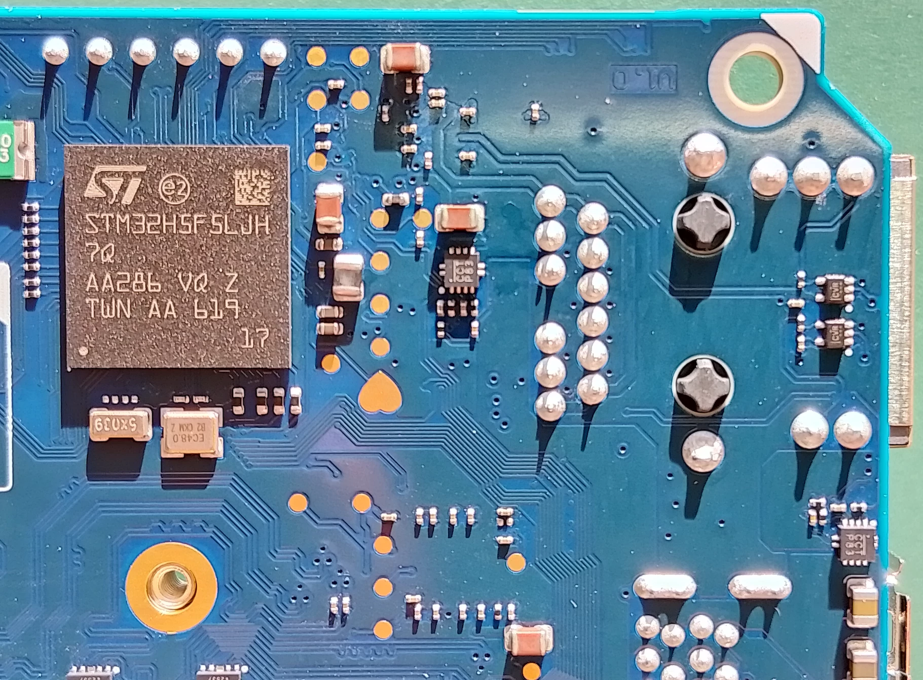

I have a recent non-STM board with an STM32H5F5LJH7Q. I understand that the STM32H5F5J-DK Discovery kit is a complete demonstration and development platform for the STM32H5F5LJH7Q. I understand that STM cannot speak for non-STM boards.
Please allow me to ask anyway if you think it might be a good idea to gain hands-on experience with the (e.g. security features) potential of STM32H5F5LJH7Q while working with the STM32H5F5J-DK in hope of being able to later transfer the knowledge/experience gained with the STM32H5F5LJH7Q (and the overall STM development ecosystem) to the recent non-STM board.
A photo of the STM32H5F5LJH7Q on the non-STM board:
