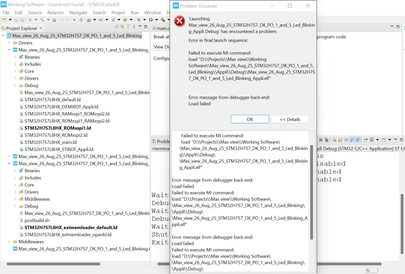

I am working with the STM32H7S78-DK board and I want to toggle the LEDs LD1 (PO1)
I followed the instructions from this GitHub resource:https://github.com/ST-TOMAS-Workshop/stm32h7s_workshop/blob/main/1_external_memory/handson/1_extmem_intro.md
and this YouTube video:
https://www.youtube.com/watch?v=sPiFBzvCWfI&t=945s
However, when I try to flash my program into the development board, I get this error:
version : STM32CubeIDE 1.17.0
I am not able to program the board because of this.
 Can anyone guide me on how to solve this flashing issue?
 Do I need to configure something specific in STM32CubeIDE or CubeProgrammer for STM32H7S78-DK?
followed above resource, but I am still facing the error 'Failed to execute MI command.' What can I do? How can I flash my code to external flash memory?

Looks like an issue with the external loader. Between NUCLEO (used during workshop) and Discovery (used on your side) there is a difference within external memory used. Could you please double check whether the page size and number of blocks is setup correctly on your side, please?
As a reference you can have a look at external loader templates for both boards present within STM32H7S Cube library:
NUCLEO-H7S3L8:
.\STM32Cube\Repository\STM32Cube_FW_H7RS_V1.2.0\Projects\NUCLEO-H7S3L8\Templates\
STM32H7S78-DK:
.\STM32Cube\Repository\STM32Cube_FW_H7RS_V1.2.0\Projects\STM32H7S78-DK\Templates\
I hope it helps.
