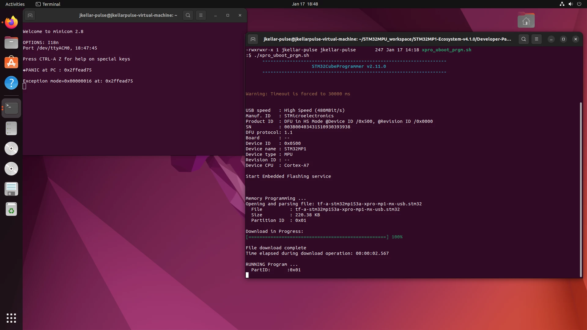

What would cause the fsbl tf-a bootloader to crash after flashing?
I'm using STM32CubeProgrammer to flash my custom target using an STM32MP153AAA MPU. I have onboard a 4GB eMMC memory. During the programming process through DFU all seems good and finishes at 100% but then sits for a bit and I get errors. Seemingly TF-A is crashing or not starting after load. I'm searching for causes and how to fix. Attached is my TSV file using in the programmer. I'm using EcoSystem 4.1.0.

Here is a screenshot showing programming and the crash if this provides any further information. Minicom is connected to UART4 from the MPU.
PatrickF
Jan 18, 2023 16:31 UTC
Hi @Community member​
This kind of crash during Flashing is maybe caused by an I2C STPMIC or DDR issue (TF-A run from SYSRAM and initialize STPMIC using I2C to power-up and init DDR in order to load uBoot on next step).
See https://community.st.com/s/article/FAQ-STM32MP1-Bring-up-procedure
Regards.

Olivier GALLIEN
Jan 18, 2023 16:33 UTC
Hi @Community member​ ,
Such an early Panic in TF-A usually highlight about a wrong Device tree settings, for example at clock level.
You might find on this community post about similar issue :
for exemple :
https://community.st.com/s/question/0D53W000005qRjZSAU/cannot-boot-up-custom-board-which-based-on-stm32mp157cdk2-only-get-message-from-uart-panic-at-pc-0x2ffdc323-exception-mode0x00000016-at-0x2ffda000
If you don't find the problem please share your TF-A DT
Hope it help,
Olivier
JKell.6
JKell.6Author
Jan 18, 2023 16:42 UTC
Thanks Patrick and Oliver your responses are spot on. After posting this I stumbled across those links you proposed and yes this is the likely cause but not due to clocking which I thought at first but I2C4. Apparently TF-A defaults to expecting a STPMIC to be connected to I2C4 which on my target I'm not using. This link as well provides some guidance on this - https://st.my.site.com/community/s/article/FAQ-STM32MP1-bring-up-troubleshooting-guide. I just need to find a way to disable the use of STPMIC by TF-A.

JKell.6
JKell.6AuthorBest answer
Jan 24, 2023 15:36 UTC
Hi Patrick,
Last week I was able to get past this Device Tree PMIC issue. Turns out there is a way to define power when not using a PMIC. What I found was it has to be defined and then specifying the code below in the device tree works. And it'd be necessary to do this for other device trees as well (e.g. U-Boot, Kernel) in the set.
