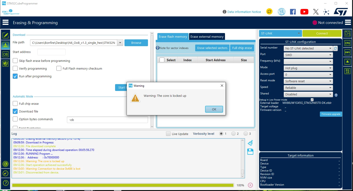

I am using the STM32CubeProgrammer v2.2.3 with MX66UW1G45G_STM32N6570-DK external loader for the STM32N6570-DK.
After reloading the STM32N6570-DK demo that came with the kit, I get the following error message (see below). Most of the demo runs normally except the AI demo won’t run at all now (nothing on the display). LEDs LD3 and LD4 turn red only when the AI demo is selected from the menu.
NOTE: I can download a new GUI from TouchGFX with no issues at all.
Here is the log...

09:12:36 : Warning: The core is locked up
09:12:36 : Start operation achieved successfully
09:13:00 : Warning: Connection to device 0x486 is lost
09:13:01 : Disconnected from device.

Problem solved. I didn’t realize the DK current consumption has spikes >500mA during AI ….USB-C to USB-C cable connected directly to a wall charger, everything runs ok now.
