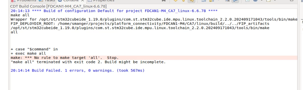

Part of my problem has been solved. I re-installed 1.19.0 of the STMCubeIDE and I am able to create an OpenSTLinux project.

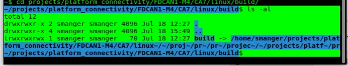

However, I am having a problem building that project. It looks like the `make` may be started in the wrong folder.
I've tried tracking it down and had no luck. However, I did come across this:
which shows a circular path to my build folder.
