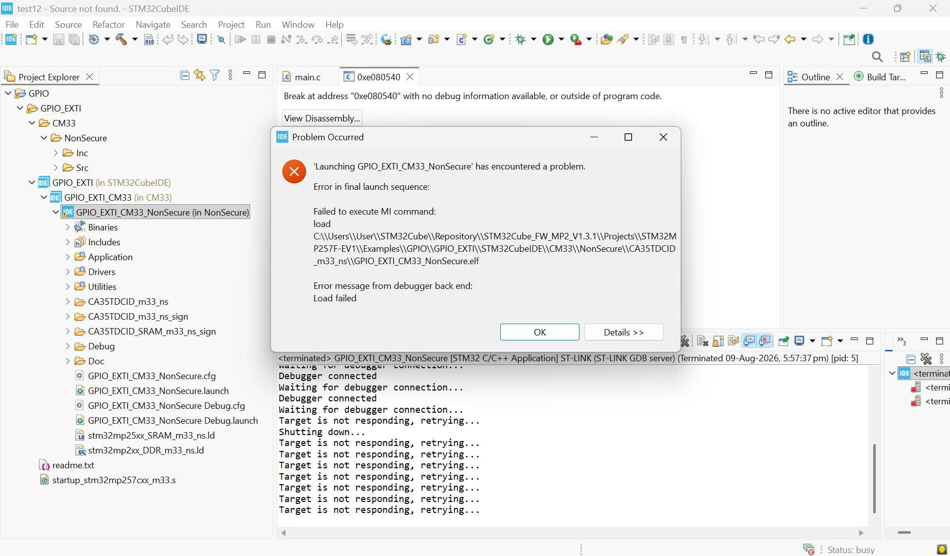

- CubeIDE debug configuration: Load Mode = "thru JTAG/SWD link (Engineering mode)", Access port = "8 - Cortex-M33", SWD interface
i have attached debug error screenshot.
i want to debug a standalone (bare-metal) application running on the Cortex-M33 over SWD.

Yes, the M33 can be debugged over SWD, but boot/provisioning and security state matter. On the MP257F-EV1, first verify the device is in Development mode, RDP/TZEN settings allow debug access, and that ST-LINK is correctly connected to the M33 access port. You generally don’t need SD/eMMC/QSPI just to establish the SWD debug connection; the key is getting the M33 into a debuggable state and loading the bare-metal image through the supported debug flow.

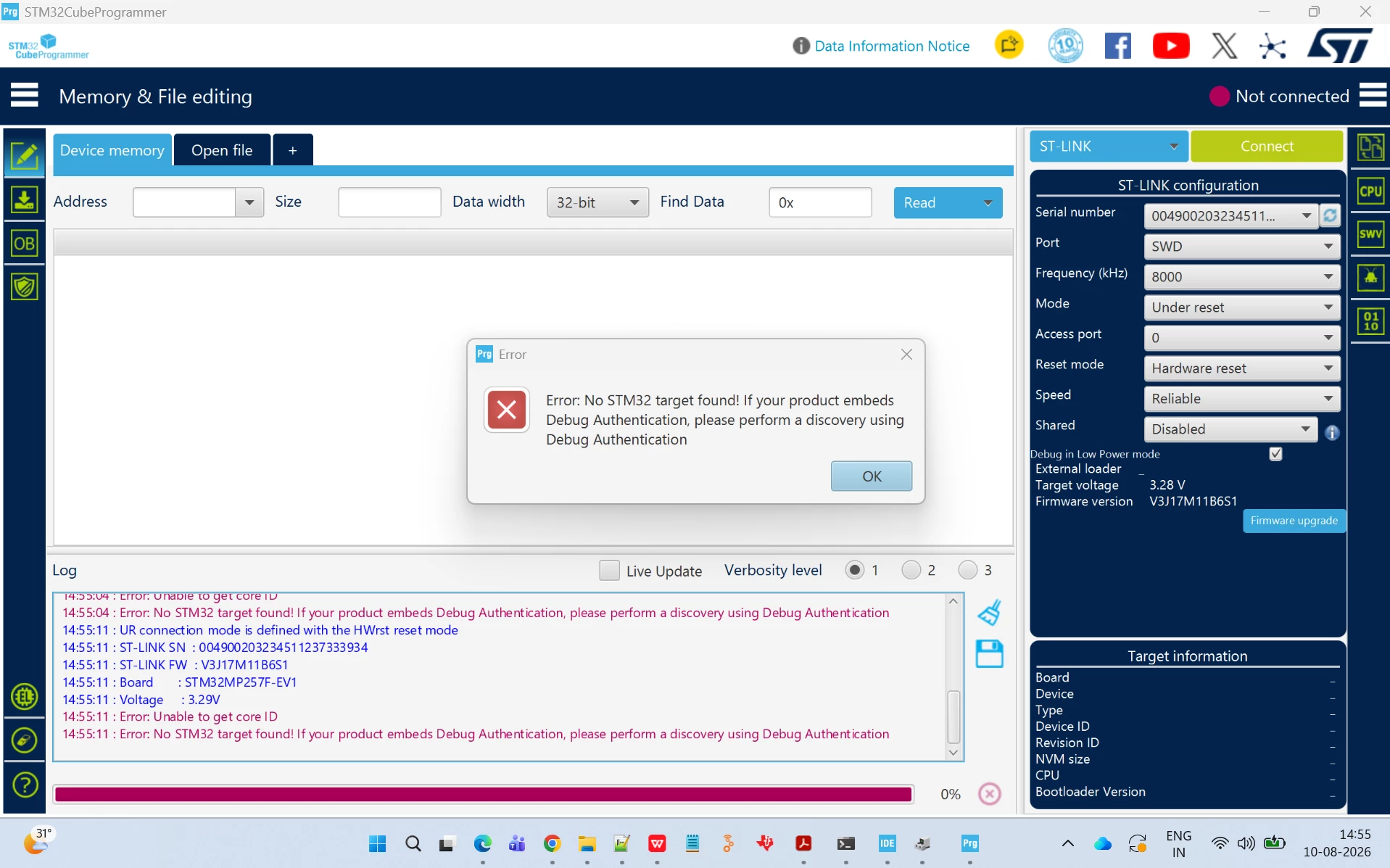

ST-LINK connection attempt via STM32CubeProgrammer:
14:52:16 : STM32CubeProgrammer API v2.23.0 | Windows-64Bits
14:54:39 : UR connection mode is defined with the HWrst reset mode
14:54:39 : ST-LINK SN  : 004900203234511237333934
14:54:39 : ST-LINK FW  : V3J17M11B6S1
14:54:39 : Board       : STM32MP257F-EV1
14:54:39 : Voltage     : 3.28V
14:54:39 : Error: Unable to get core ID
14:54:39 : Error: No STM32 target found! If your product embeds Debug Authentication, please perform a discovery using Debug Authentication
I also tried both Access Port 0 and Access Port 1 in the ST-LINK configuration, both return the identical 'Unable to get core ID' / Debug Authentication error
So ST-LINK itself connects fine (board identified correctly, voltage nominal, firmware version reads out), but the actual core ID read fails, and CubeProgrammer is explicitly flagging Debug Authentication.
How do I check the current RDP and TZEN settings on this board through STM32CubeProgrammer (or another supported tool)
