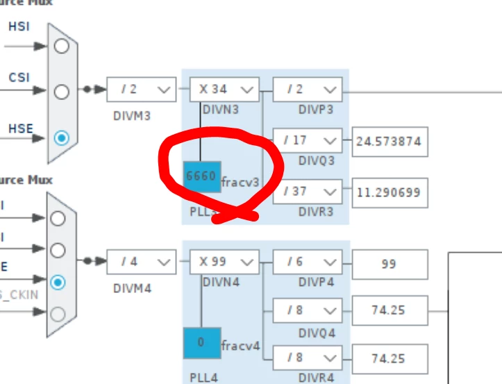

The MX PLL3 calculation is generating 208.87793 MHz not 204 MHz. Is this a bug or am I missing something?
I believe HSE is 24 MHz, DIVM3 is /2 (12 MHz) DIVN3 is X34 (408 MHz) DIVP3 is /2 (204 MHz) But the screen says it is 208.87793.
I thought I knew how the PLL worked. And it is not like this.
I have a screen shot.
TDKBest answer
Dec 17, 2021 00:28 UTC
You have a fractional N set in your PLL. Set it back to 0 to get the expected results.

PatrickF
Dec 17, 2021 07:39 UTC
@TDK gives the right answer. 24/2=12MHz, 12MHz*(34+6660/8192) = 417.755859MHz with DIVP3=2 end up to 208.8779297MHz.

Dec 18, 2021 20:08 UTC
I missed that completely. Thank you.
I do not remember changing it. And do not know why I would.
