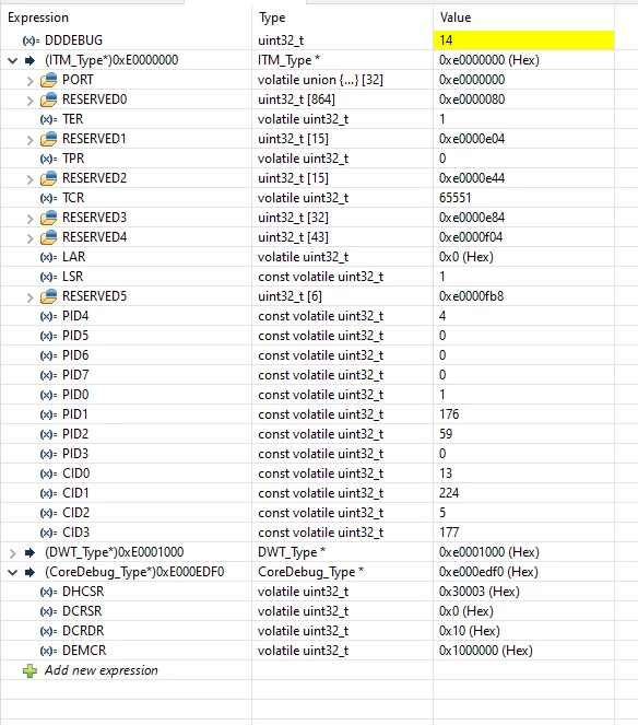

The code compiles without errors, and it loads and executes fine, I can see in the debugger the counter incrementing (even in Live Expressions) and the ITM_SendChar function is called correctly.
I also double-checked the PCB design and I can confirm that the TRACESWO / SWO pin is connected correctly to the ST-Link (ST_Link V3 MNIE - an offical ST one, very small without a case). The SWDIO and SWCLK pins are connected and working otherwise the debugging would not work.
The problem is I get absolutely nothing in any of the SWV windows (SWV Data Trace, SWV ITM Data Console, etc.), neither "test" nor can I see the DDDEBUG variable changing. The config is attached and the recording is enabled. I tried both OpenOCD and GDB, they give exact same results (debugging works but not SWV).

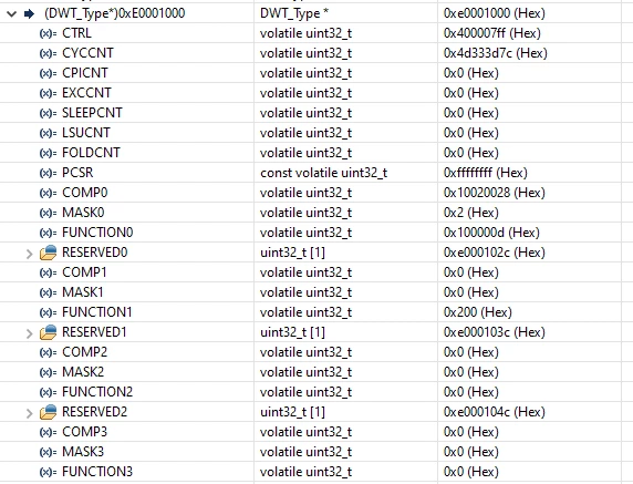

PS: I attached many screenshots of the configuration, including the ITM registers which look correct (but I'm no expert about these). See also the OpenOCD and GDB commands here:
C:\ST\STM32CubeIDE_1.17.0\STM32CubeIDE\plugins\com.st.stm32cube.ide.mcu.externaltools.openocd.win32_2.4.0.202409170845\tools\bin\openocd.exe "-f" "stm32mp157D_DK1_TEST_CM4.cfg" "-s" "C:/Users/Administrator/STM32CubeIDE/workspace_1.17.0/stm32mp157D_DK1_TEST/CM4" "-s" "C:/ST/STM32CubeIDE_1.17.0/STM32CubeIDE/plugins/com.st.stm32cube.ide.mcu.debug.openocd_2.3.0.202411041438/resources/openocd/st_scripts" "-s" "C:/ST/STM32CubeIDE_1.17.0/STM32CubeIDE/plugins/com.st.stm32cube.ide.mpu.debug.openocd_2.2.0.202409171044/resources/openocd/st_scripts" "-c" "gdb_report_data_abort enable" "-c" "gdb_port 3333" "-c" "tcl_port 6666" "-c" "telnet_port 4444"
C:\ST\STM32CubeIDE_1.17.0\STM32CubeIDE\plugins\com.st.stm32cube.ide.mcu.externaltools.stlink-gdb-server.win32_2.2.0.202409170845\tools\bin\ST-LINK_gdbserver.exe -p 61234 -l 1 -d -z 61235 -s -cp C:\ST\STM32CubeIDE_1.17.0\STM32CubeIDE\plugins\com.st.stm32cube.ide.mcu.externaltools.cubeprogrammer.win32_2.2.0.202409170845\tools\bin -m 2 -g
I am using CubeIDE 1.17.0, and the firmware on the ST Link is updated to the newest available. The STM32MP1 firmware package is also the latest.
ITM SWT and CoreDebug Registers:

Ok, here are my findings:
  1. The Trace CLK needs to be enabled otherwise Cube gives a massive error while trying to set the ITM/DWT registers
    • check in Linux with:
      cat /sys/kernel/debug/clk/clk_summary | grep -E 'trace|enable|count|---
      (run "debug 1" first on my Linux to mount /sys/kernel/debug)
    • Enable it from the debugger by setting the "TRACECKEN" bit in RCC_DBGCFGR
    • Then check again in Linux, the "hardware enable" should have changed from N to Y
  2. In CubeIDE, the "Core Clock" is NOT the M4 clock but the Trace clock (the one given by the command above), this needs to be set correctly (in my case 133.25 MHz)
  3. Apparently this only works with OpenOCD and not with the ST-LINK GDB Server
