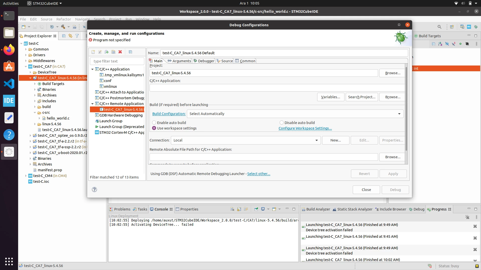

STMCubeIDE Activation DeviceTree Failed with STM32MP157A-DK1 ARM Cortex-A7
Hi, i just started working/learning STM cards as an intern. I want to run C/C++ codes on STM32MP157A-DK1 ARM Cortex-A7.
I did the getting started tutorials at wiki, and im using environmet version 2.1.0 release
I followed these posts:
https://community.st.com/s/question/0D53W00000M9GphSAF/using-stm32cubeide-for-developing-linux-user-space-applications
https://wiki.st.com/stm32mpu/wiki/How_to_manage_OpenSTLinux_project_in_STM32CubeIDE
Then I wrote an the most basic hello world code. just want to get an build, deploy and see if its working properly then i will start working on the task that i given.
#include <stdio.h>
int main()
	printf("hello world\n");
	return 0;
The problem is when i press : Run as -> STM33 Cortex-A Linux deployment it gives an error and says : " Activation DeviceTree... failed"

Hi @Mustafa Çerçi​ ,
Seems you are not using the correct Debug Configuration .. your userspace app is then consider as a DeviceTree.
Select your project, right-click Debug as... > Debug Configurations.
Then create a C/C++ Remote Application debug configuration, double clicking on it.
Hope it help,
Olivier

Hi thanks again for the fast reply,
Then what should i choose other settings? do i have anything else to do because it seem like not working (sorry if i'm being annoying)0693W000006E89DQAS.png
The OpenSTLinux SDK provides you with the --sysroot= option set to the SDK rootfs.
It means you have access to the kernel header includes:
#include <linux/spi/spidev.h>
for example.
Rootfs is located in the toolchain: .../3.1-openstlinux-5-4-dunfell-mp1-20-11-12/sysroots/cortexa7t2hf-neon-vfpv4-ostl-linux-gnueabi/
Hope it help,
Ludovic

Dec 4, 2020 11:18 UTC
ahh thank you sir! all this time i just need to create only a C project. I was trying to create STM32 Project then include OpenSTLinux into it and build a C project. I thought only way i can work with Cortex A7 core with that way, there must be a stm32 project and i need to to everything inside it. But it seems like if i had SDK it is enough you say.
