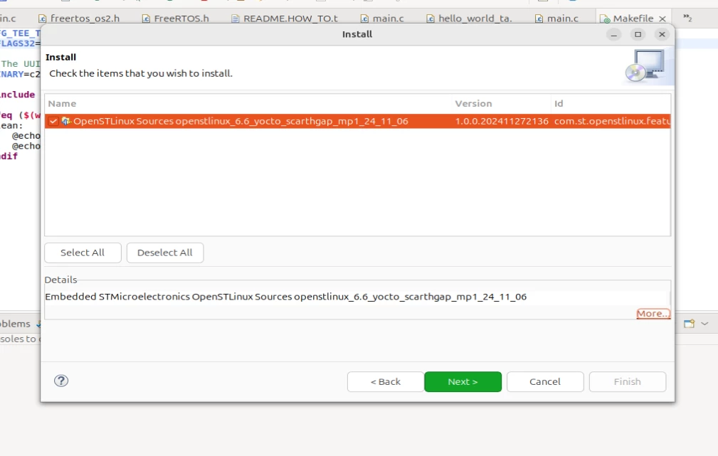

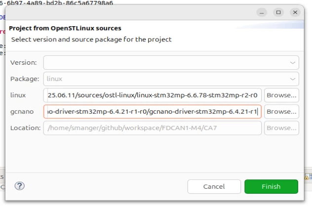

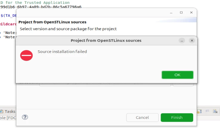

I upgraded to the new development release. I can not create a OpenSTLinux project for my ioc file. I am working with the st32mp157f-dk2 and have installed the new v6.1.0 ecosystem. I have upograde rhw STM32CubeiDE TO V1.19.0.
I set the SDK Root. an loaded the plugins. I have been able to create a user space and trusted applications. However, I can not get the OpenSTLinux project to load.

I uninstalled the older version of yocto from my IDE then retried again. I do not get a newer version available.
stm32mp-openstlinux-6.6-yocto-scarthgap-mpu-v25.06.11 is not available.

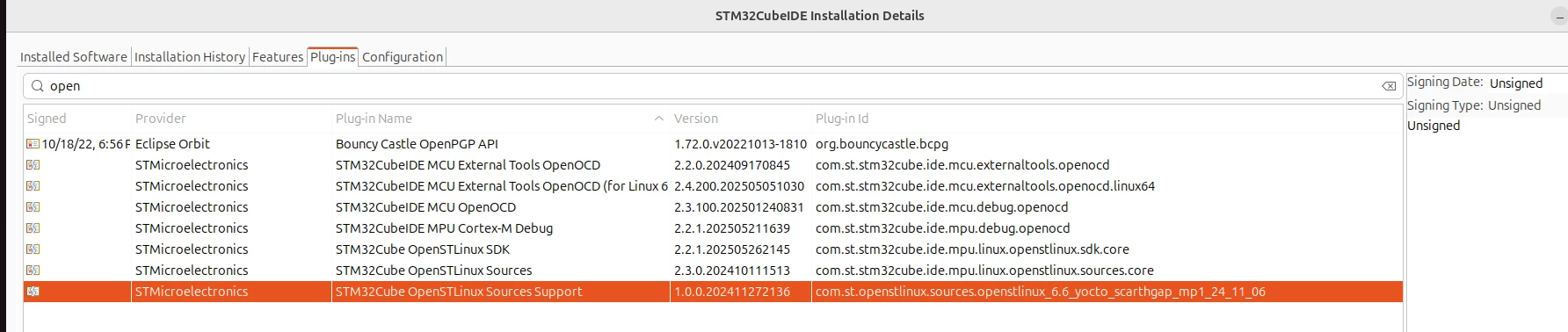

I'm trying to find the plugin for the June 11, 2025 release for the OpenSTLinux Sources Support.

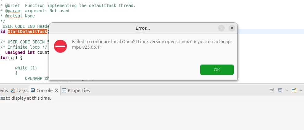

If I try to go back to the old SDK (6.0.0) when I try to setup OpenSTLinux I get this error:

Jul 16, 2025 9:45 AM UTC
Hello smanger,
We're managing this issue and will update the plugin ASAP.
Sorry for inconvenience.

At first, I thought is was just the one plug-in. I see that there are more than one plug-in for the old version.
Will these automatically update after they get published? Is there any timeline?
christelle burguera
Jul 18, 2025 8:12 AM UTC
Hello smanger
if it's for MP1 serie you can now try again, the delivery was done yesterday with a limitation around bootloader on MP13 (see errata wiki page : https://wiki.st.com/stm32mcu/wiki/STM32CubeIDE:STM32CubeIDE_errata_1.19.x or the MPU release note : https://wiki.st.com/stm32mpu/wiki/STM32CubeIDE_release_note for details)
for the MP2 serie, a fix is already ongoing, and we'll deliver as soon as possible.
