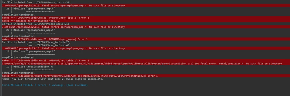

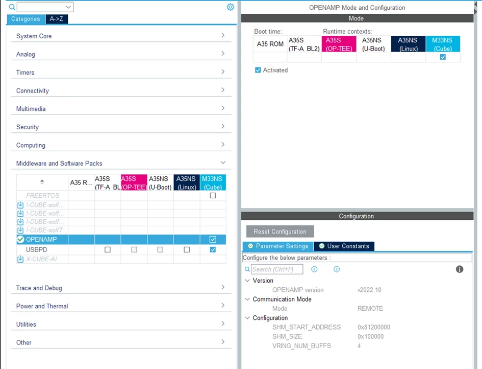

I am encountering an issue when enabling the OpenAMP middleware in CubeMX for a new project targeting the STM32MP257F‑DK board. After creating the project and activating only the OpenAMP middleware (see attached screenshot), the build fails because several required files are missing. Below is the full error message generated during compilation.
Thank you in advance for your help.

Olivier GALLIEN
March 25, 2025
Hi @Nicolas_D ,
Thanks for your post. This is a known problem we are working on. BZ197530
We hope to provide fix in coming CubeMX release.
In the meantime you might take exemple on OpenAMP application exemple provided in CubeFirmware package and bring it in your project
Olivier

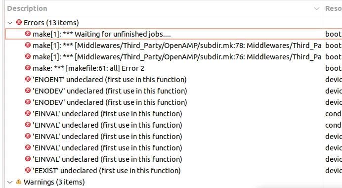

stThanhln
Visitor II
April 10, 2025
Hi @Olivier GALLIEN ,
Thanks for your suggestion, I tried and fixed the same errors with STM32MP257F-DK, but a new problem appeared, the compiler did not find some macro as shown above.
Can you give me some ideas to fix them. Thank you very much.
