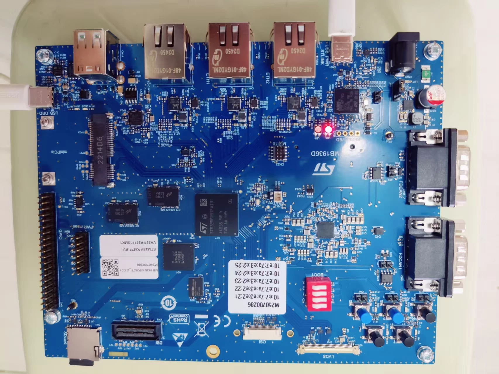

   How could STM32MP257-EV1 in DFU mode,
    I have followed the steps of STM32MP25 Evaluation boards - Starter Package for Android - stm32mpu,
1. install SetupSTM32CubeProgrammer_win64.exe
2. Run the “STM32 Bootloader.bat”
3. Set the boot switches to the off position (boot from UART/USB).
4. Connect the USB type-C (OTG) port (4) to the host PC that contains the downloaded image.
5. Insert the delivered microSD card into the dedicated slot (5).
6. Connect the USB type-C (power supply) port (1) to the power connector or a host PC, and check the power jumper position.
7. Press the reset button (7) to reset the board.
but when I check device manager, nothing new shows up at all.
attached the picture of STM32MP257-EV1 powered on

PatrickF
May 30, 2025
hi @faye_Lee
LD6 should be green (or orange).
Seems to be OFF on your picture.
This mean the supply/PC connected on CN21 has not been recognized as a valid USB Type-C supply (required to have the 5V supply being applied to the rest of the board).
Regards

faye_LeeAuthor
June 5, 2025
Hi PatrickF,
   So could I connect  5V adapter to CN21? Do I need to remove step6( Connect the USB type-C (power supply) port (1) to the power connector or a host PC, and check the power jumper position.)?
What document is it of this picture, could you share with me?Thank you
PatrickF
June 5, 2025
Yes, a 5V-12V 15W adapter is accepted on CN20, need JP4 to be moved to the other position.
Documentation are from https://www.st.com/en/evaluation-tools/stm32mp257f-ev1.html
