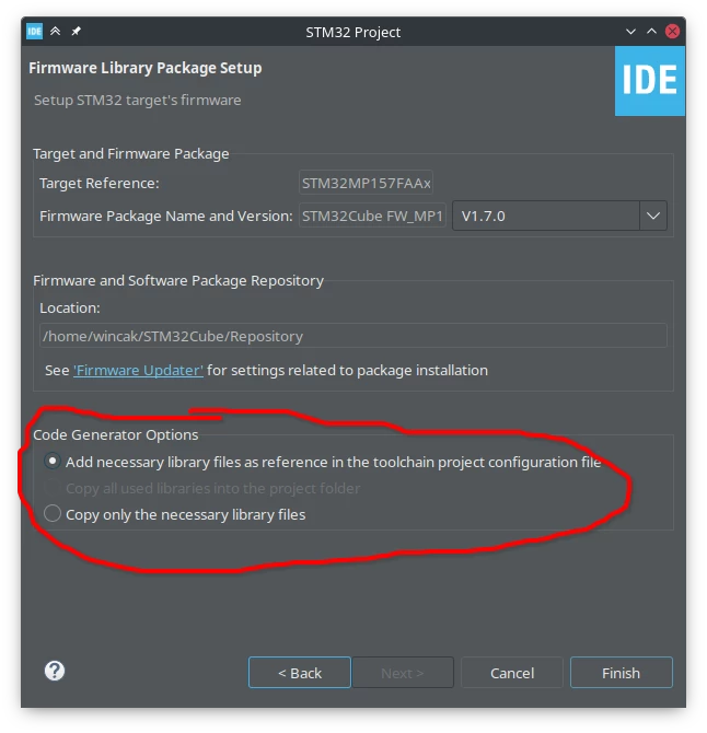

Hello Sem,
have you figured it out? I seem to have a similar problem, with STM32MP157FAAx and CubeIDE 1.18.1. A new, empty project with default config works - CM4 project compiles OK.
If I only enable FreeRTOS (with CMSIS_V2) including changing the time base to TIM1 and enabling Newlib-reentrant, compilation fails with newlib-freertos.h not found.
Disabling Newlib-reentrant and ignoring the IDE warning results in
... Middlewares/Third_Party/FreeRTOS/Source/CMSIS_RTOS_V2/cmsis_os2.c:30:10: fatal error: freertos_mpool.h: No such file or directory
I found two ways of resolving this problem:
1) Do not copy files from the package, reference the package instead. This option can be selected when creating a project:
2) Manually copy the missing files and add include paths as necessary. Unfortunately running "Generate code" will overwrite all manual changes.
I've tried option 2 and after fixing some problems like conflicting SysTick_Handler definitions got the code to at least compile.
