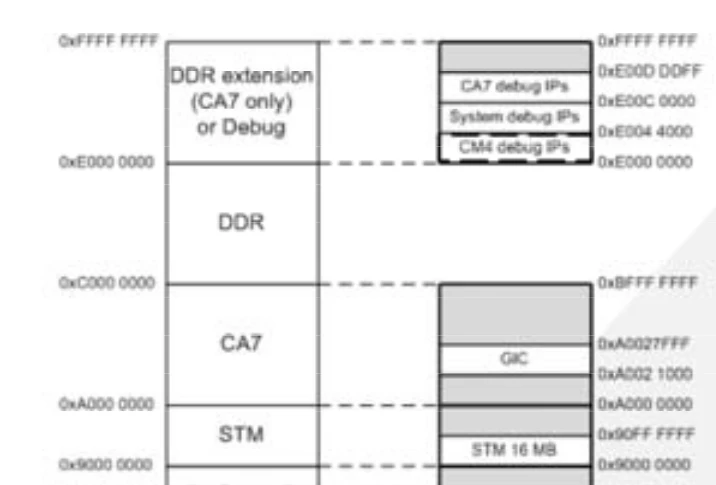

[ 0.273935] Unhandled fault: imprecise external abort (0x1c06) at 0x97638f7a
This seems to be a memory access violation. The 0x9 memory location seems to be in I/O space but information is hard to find. One slide from ST refers to 0x9000000-0x9FFFFFF as "STM".  Why would the kernel attempt to access this space. More even curious, why for does this happens just after or at the UART ?

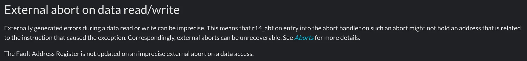

The error refers to a Register r3 information: NULL pointer, is this a bug in the ST code ?
ARM's explanation is very "encouraging". It means that the address may have no relation to the errors.So "something happened but we do not know" error.
