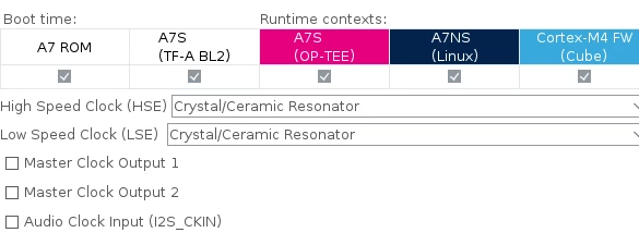

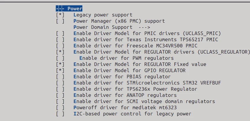

STM32MP157AAA  custom board with DRAM, SD- EMMC, USB and UART , Discrete power( no PMIC) . The board uses discrete oscillators for HSE and RTC, so they are set as Crystal OSC for both in CubeMX USB, UART are correctly configured (same as the default peripheral settings). DRAM is correctly setup based on the used DRAM chip. In .config the PMIC options is disabled and legacy power enabled
The CubemX settings were verified by the SOM manufacturer as being correct. This board has run a previous version of the ECO system without problems.

d. Enable legacy power
e. in .config the "Enable SCMI agent SMCCC" and OP-TEE options are enabled, as well as Clock-> clock driver support =>Enable SCMI clock driver (and RCC clock driver is also enabled)

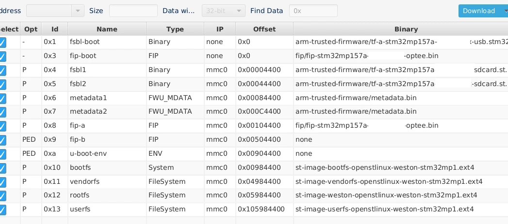

After building al binaries flashing fails with
11:16:29 : File download complete
11:16:29 : Time elapsed during download operation: 00:00:02.936
11:16:29 : RUNNING Program ...
11:16:29 : PartID: :0x01
11:16:29 : Start operation done successfully at partition 0x01
11:16:29 : Memory Programming ...
11:16:29 : Opening and parsing file: fip-stm32mp157a-board-optee.bin
11:16:29 : File : fip-stm32mp157a-board-optee.bin
11:16:29 : Size : 1.20 MB
11:16:29 : Partition ID : 0x03
11:16:29 : Download in Progress:
11:16:33 : File download complete
11:16:33 : Time elapsed during download operation: 00:00:04.134
11:16:33 : RUNNING Program ...
11:16:33 : PartID: :0x03
11:16:33 : Reconnecting the device ...

Recompiled u-boot now wbased on the trusted defconfig tree but with legacy power instead of PMIC, gives another panic:
[ttyUSB0]: PANIC at PC : 0x2ffec8f3
[ttyUSB0]: 8f3n mode=0x00000016 at: 0x2ffec

Found this topic: The external clock of our board is a crystal, and DK2 is an oscillator. After setting the TF-A DT clock correctly, our board can boot BL2 until U-Boot.
Tried all different settings with Cube MX: Crystal, Disabled, Bypass but nothing works to fix the panic after Cubeprogrammer transferred partition 0x03 Fip-boot and then shows a "reset". the usb connection is lost and cubeMx dumps a bunch of warning dialog boxes.
https://community.st.com/t5/boards-and-hardware-tools-mpus/cannot-boot-up-custom-board-which-based-on-stm32mp157c-dk2-only/td-p/280969
This board uses also a crystal, but the link mention on many replies from st:  https://wiki.st.com/stm32mpu/wiki/Clock_device_tree_configuration_-_Bootloader_specific   is broken. Reported this several times but no one is helping ?
CubeMX is set correctly for crystal:

Is this right ? How the select bypass so that it generates:
&clk_hse {
st,digbypass;
