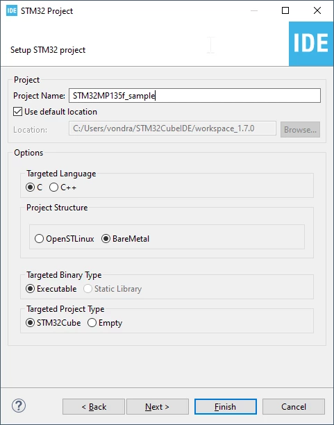

Can I use Windows and STM32CubeIDE to develop application using STM32MP135FAF7 (STM32MP135F-DK discovery kit).
I tried to create empty project based on this discovery kit but it ended with message
"This project requires OpenSTLinux version 'openstlinux-6.1.-yocto-mickledore-mp1-v23.06.21', setup it now ?"
and finally error message "This operation is only supported on Linux!"
I would like to program "bare" A7 chip using STM32IDE using STLink, is it really possible ?

ravoAuthor
Jan 17, 2024 15:04 UTC
Dear @Erwan SZYMANSKI,
thanks for response. I fellow up already steps from AN5360 (an5360-getting-started-with-projects-based-on-the-stm32mp1-series-in-stm32cubeide-stmicroelectronics.pdf)
STM32 New Project
Board Selector - STM32MP135F-DK
I forgot to swap to bareMetal. I must have been blind
In meanwhile I also tried another approach to generate IOC with CubeMX and import to CubeIDE it will create working project... I was still wondering where I made a mistake in CubeIDE.
So many thanks for these another wiki pages.
So project creation works fine now. No I can compile it, but how to program/ debug project ?

ravoAuthor
Jan 19, 2024 12:38 UTC
Update:
After restarting PC the gdb server now seems start working. I am now able to start debugger and run code...
