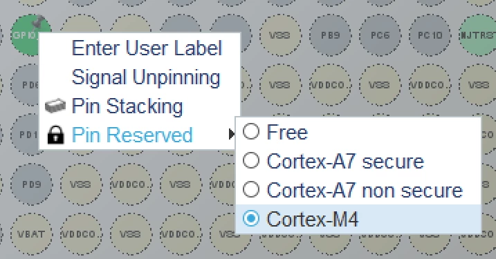

Hello all,
I am used to the regular MCUs STM32Fx families where I'm used that the main.h has all the #defines of the GPIOs and other peripherals.
I'm now using STM32MP1 generating code for CM4 and noticed it is generate any #define information.
also, it is not initializing GPIOs state.
Why is it generating no initialization of GPIOs or other user label #defines?
TDKBest answer
Mar 29, 2022 16:33 UTC
GPIO pin context is assigned at the pin level.
Right click the pin in pinout view -> Pin Reservation -> Cortex M4

Mario Luzeiro
Mar 29, 2022 16:22 UTC
IOC Attached.
I can't find any configuration to assign it to each core, where should I look for it?
TDKBest answer
Mario Luzeiro
Mar 29, 2022 17:04 UTC
Thanks, that was a new (hidden) option for me!
