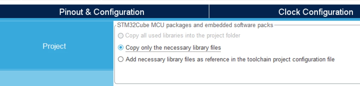

i updated CubeMX to version 6.14 and therfor update STM32MP1 firmware package to v1.7.0
- STM32Cube FW_MP1 V1.7.0
In my project i am using the Option to copiy only need library files to project
But this does not work correctly.
There are some files, header files, missing under Middlewares\Third_Party\FreeRTOS
The files are all existing in the packge under C:/Users/XYZ/STM32Cube/Repository/STM32Cube_FW_MP1_V1.7.0
but not being copied to Project folder.
Can anybody confirm this issue?
P.s. when i use firmware package 1.6.0 with CubeMX v6.14 everything is fine.
