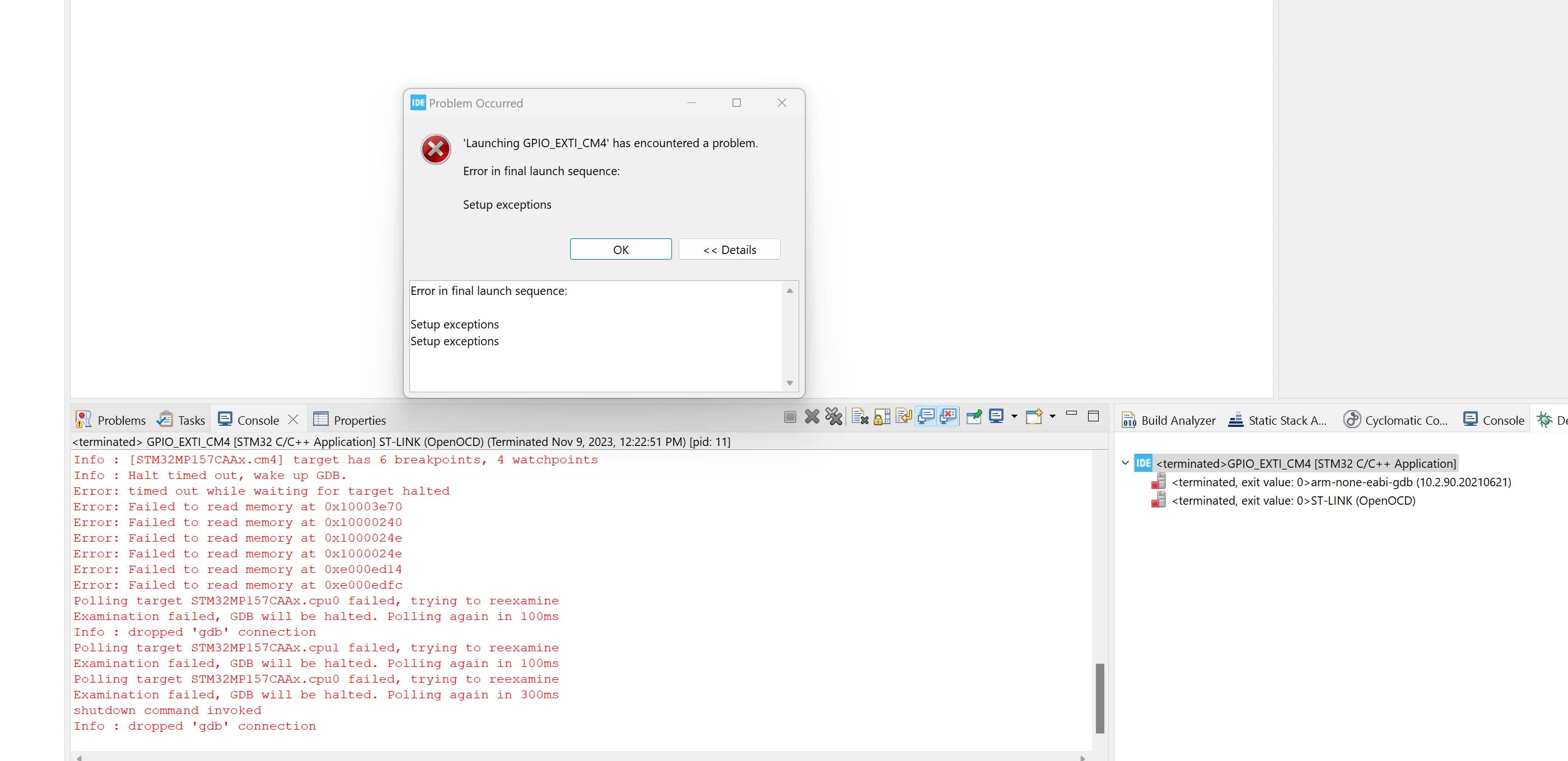

STM32CubeIDE: Has encountered a problem
I debug a simple project STM32MP15 M4 GPIO-EXTI-CM4, using engineering mode. It worked couple days ago. Today when I tried again, I got the error below and it doesn't make sense.

Correct BOOT0, 1, 2 to engineering mode then it works again.
