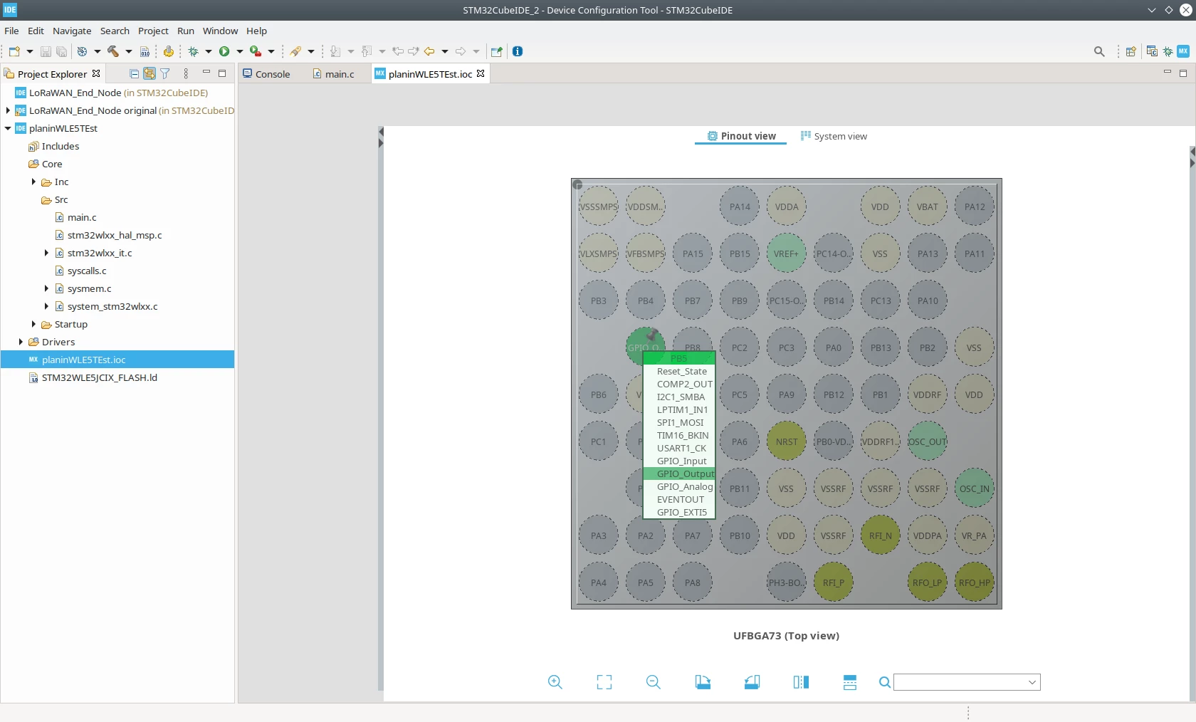

STM32CubeIDE: CPU stuck at 100% when editing IOC files
I am using STM32CubeIDE v1.4.2 and experiencing issues with editing IOC files. I am using Ubuntu 18.04.05 as recommended by ST. Often when when I am using the integrated Cube MX editor I experience 100% CPU load and the IDE locks up. I have tried increasing the Java heap size to 4MB. 3 years ago I did a project using the separate Cube MX program and had no issues with it but since ST integrated it into the IDE it seems pretty much unusable. Does anyone have any ideas how to make this software operable?

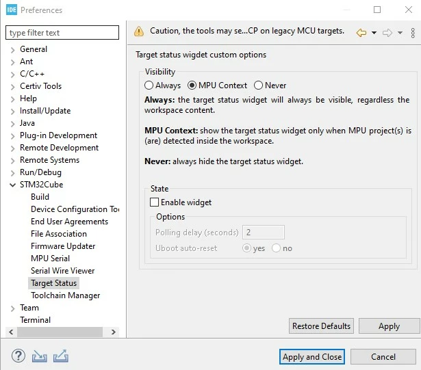

Hi I had the same issue. When I open ioc file, CPU hits %100. I used visualvm tool to profile stm32cubeide to find which thread is consuming time.
It was plug-in org.eclipse.cdt.native.serial. I searched online about the issue and found similar complaints about eclipse cdt serial plugin.
Solution is keeping STM32 development board's programming USB cable connected to the PC. In my case CPU usage hits to %100 if board's programming cable is not connected. When I plug the board to PC and open stm32cubeide CPU usage goes back to normal/acceptable level.

@ASay.1​ what is your setup here (target status) ?
0693W00000Bcex3QAB.jpgMaybe some tricks ...
ASay.1
Jul 2, 2021 11:21 UTC
MPU Context

@ASay.1​ Some extra question trying to get your context.
MPU context setup ok Thanks for sharing. What about your workspace content then ... any project dealing with a STM32MP1 device ?
