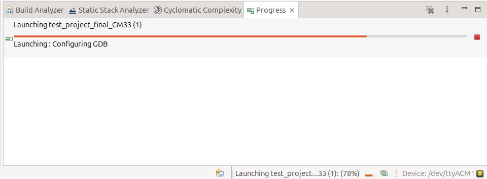

Hi, I am using STM32MP257F-DK microcontroller. I have never used a dual cortex before. All I want to do is to generate a simple STM32CubeIDE project which also has a .ioc file. I want to debug it via CubeIDE.
1) Do I need OpenAmp to successfully flash the code?
2) I have already set up the SDK, are there other settings I need to take care of?
When I try to flash my current project, It always stops at 78% like shown in the picture below.

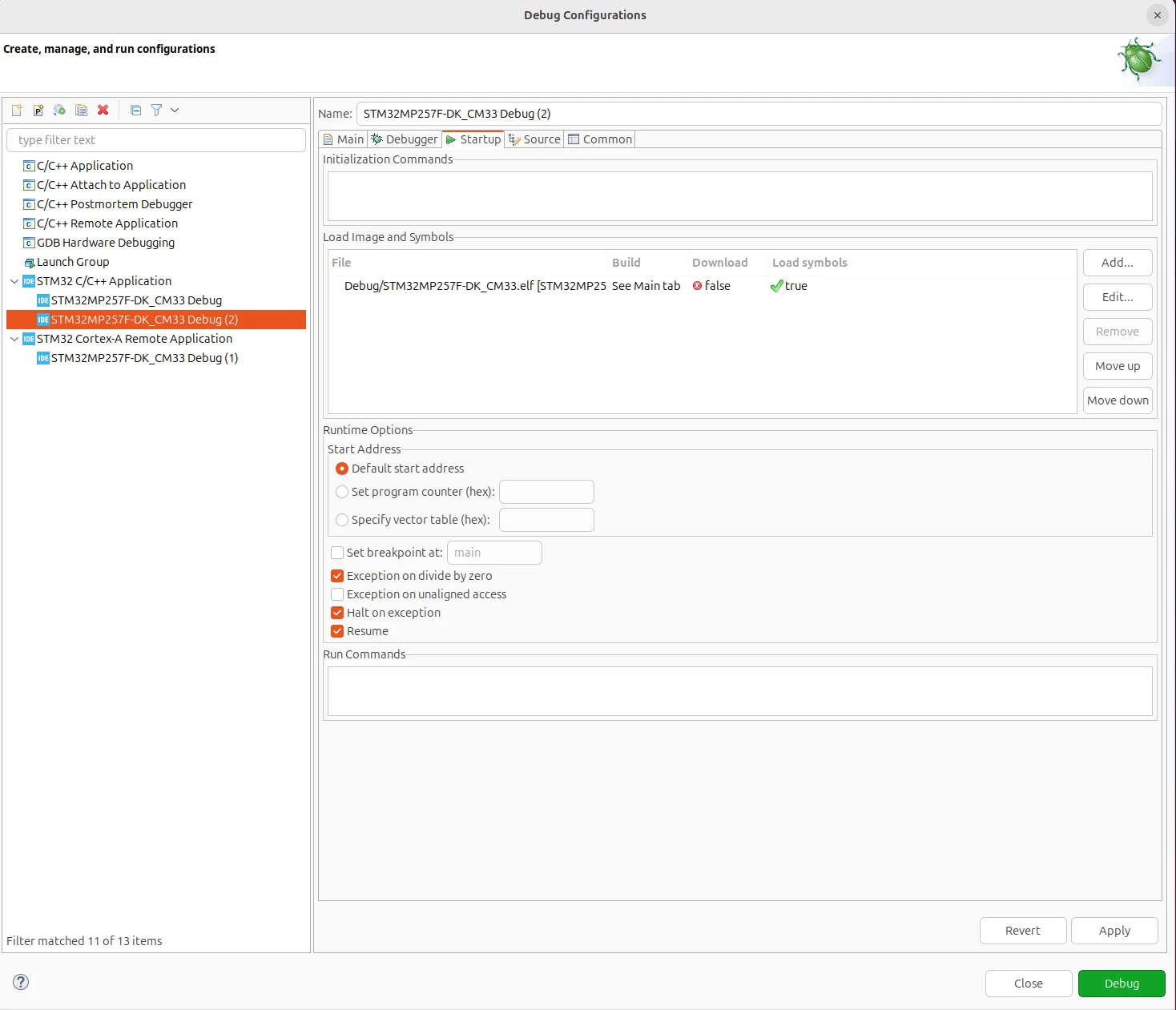

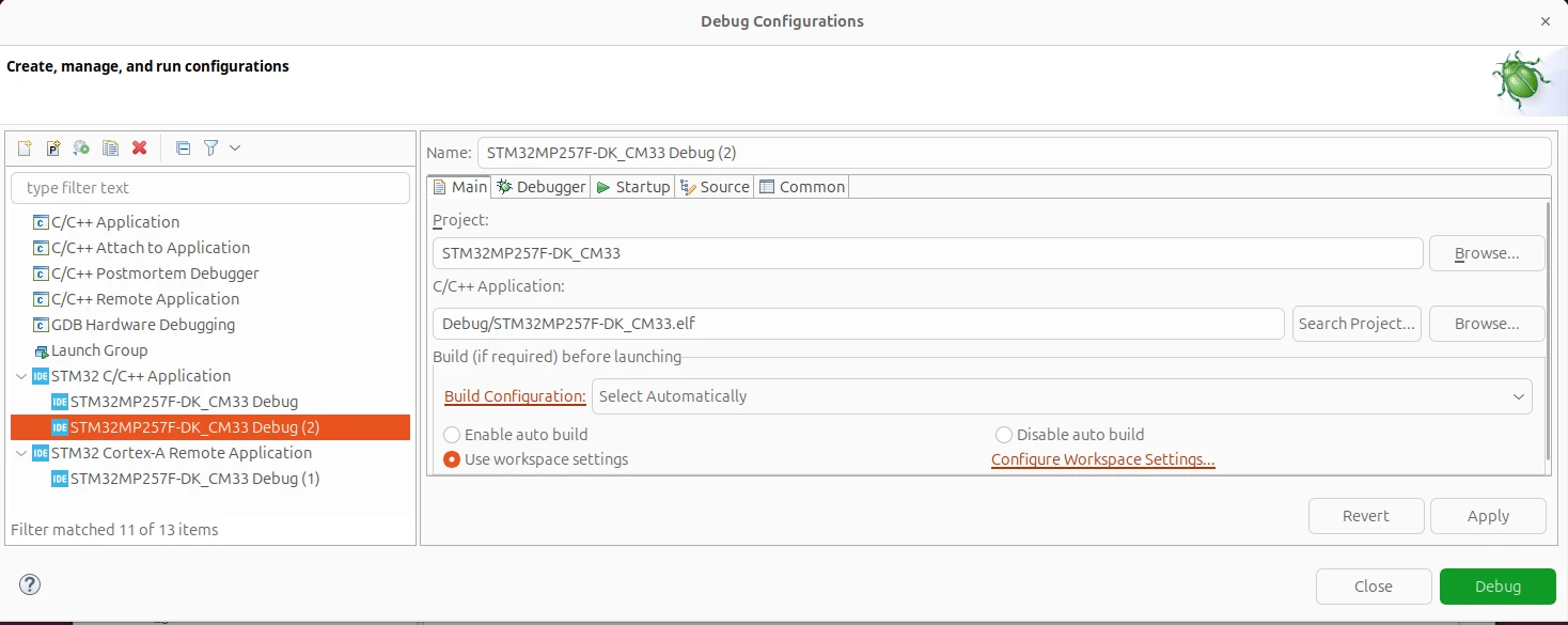

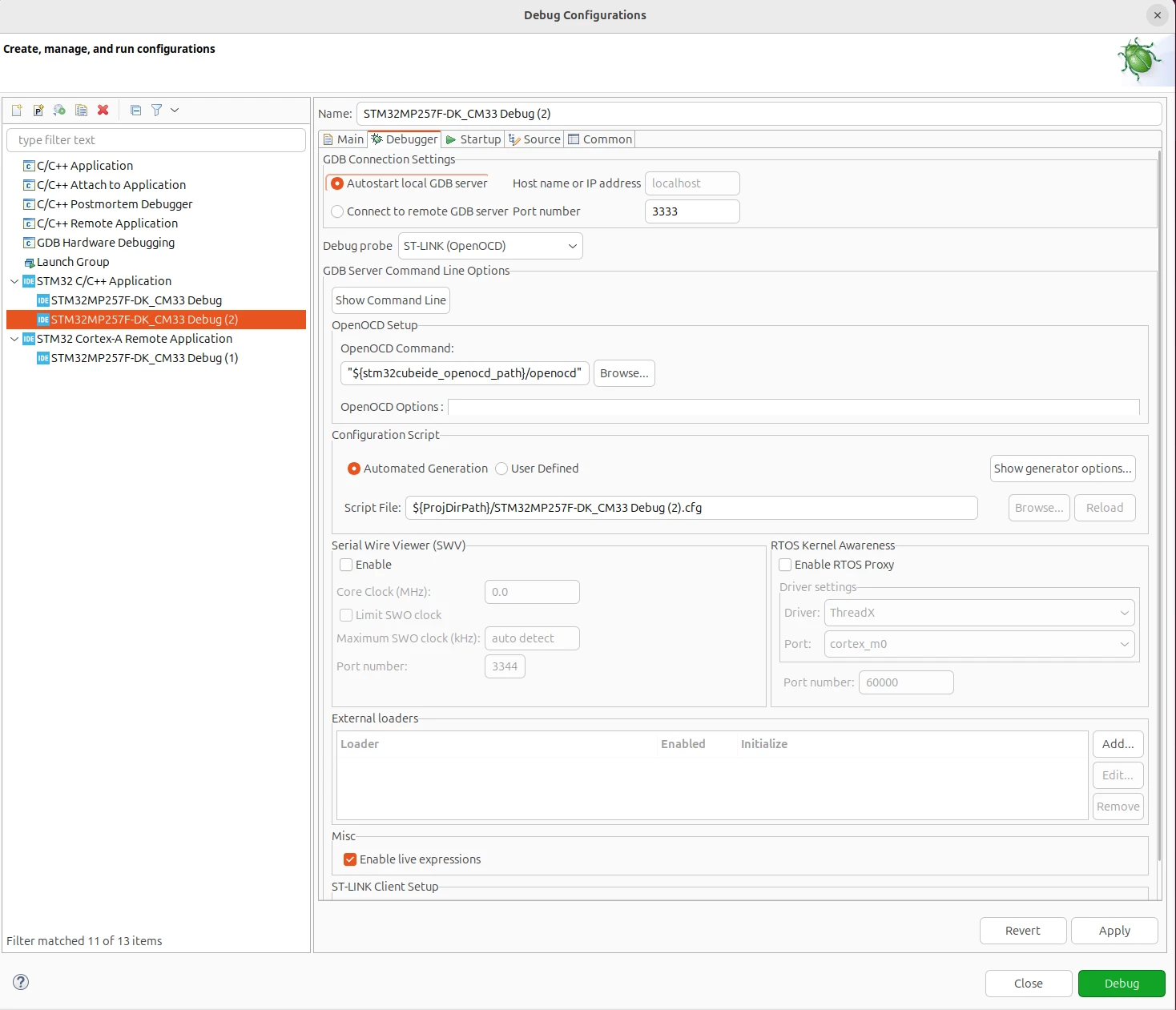

Could you please check the GDB debugger on the debug Configurations
BTW : could you please share the log .

Here are my debug settings:

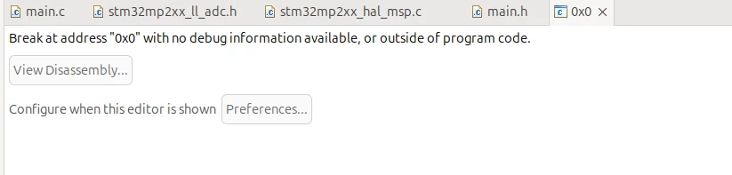

Then clicking on the "Debug" button gives the following response:
And the following output log is printed to the console:

Warn : [STM32MP257FAKx.m33] target was in unknown state when halt was requested
Info : [STM32MP257FAKx.m33] external reset detected
Error: timed out while waiting for target halted
Error executing event gdb-attach on target STM32MP257FAKx.m33:
Info : New GDB Connection: 1, Target STM32MP257FAKx.m33, state: reset
Warn : GDB connection 1 on target STM32MP257FAKx.m33 not halted
Info : accepting 'gdb' connection on tcp/3333
Info : New GDB Connection: 2, Target STM32MP257FAKx.m33, state: reset
Warn : GDB connection 2 on target STM32MP257FAKx.m33 not halted
Error: [STM32MP257FAKx.m33] not halted (add breakpoint)
Error: [STM32MP257FAKx.m33] can't add breakpoint: target running
Info : Halt timed out, wake up GDB.
