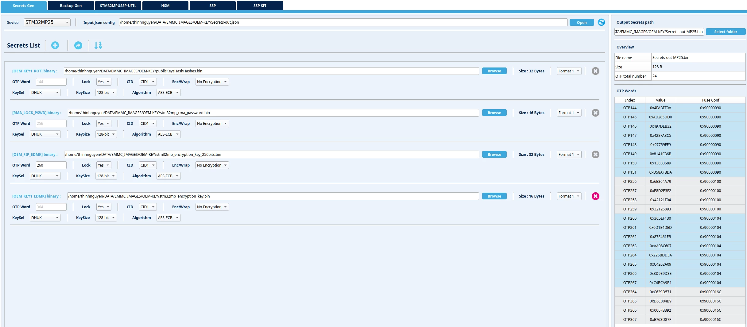

My goal is to create a SSP payload and write it to the OTP of the STM32MP257F chip. The OS running on my KIT is based on OpenSTLinux.
To get the SSP Payload, a Secret file is required. I just need secure boot.
I refer to the following sources:
The contents of my Secret file will include the components as shown below. (Json file attached)
Is a secret file with such components enough for secure boot? And please advise if there are any invalid options in the Secret list

Hello @ThinhNguyen,
On MP2x A35TD these four elements are sufficient.
Keep in mind that the first two elements (OEM_KEY1_ROT and RMA_LOCK_PSWD) are mandatory. The two others are optional, depending on what you want to achieve :
  • OEM_FIP_EDMK is used to decrypt the FIP binaries (OP-TEE, U-Boot). If you do not encrypt your FIP, it is not required.
  • OEM_KEY1_EDMK is used to decrypt the FSBL (TF-A). If you do not encrypt the FSBL, it is not required.
